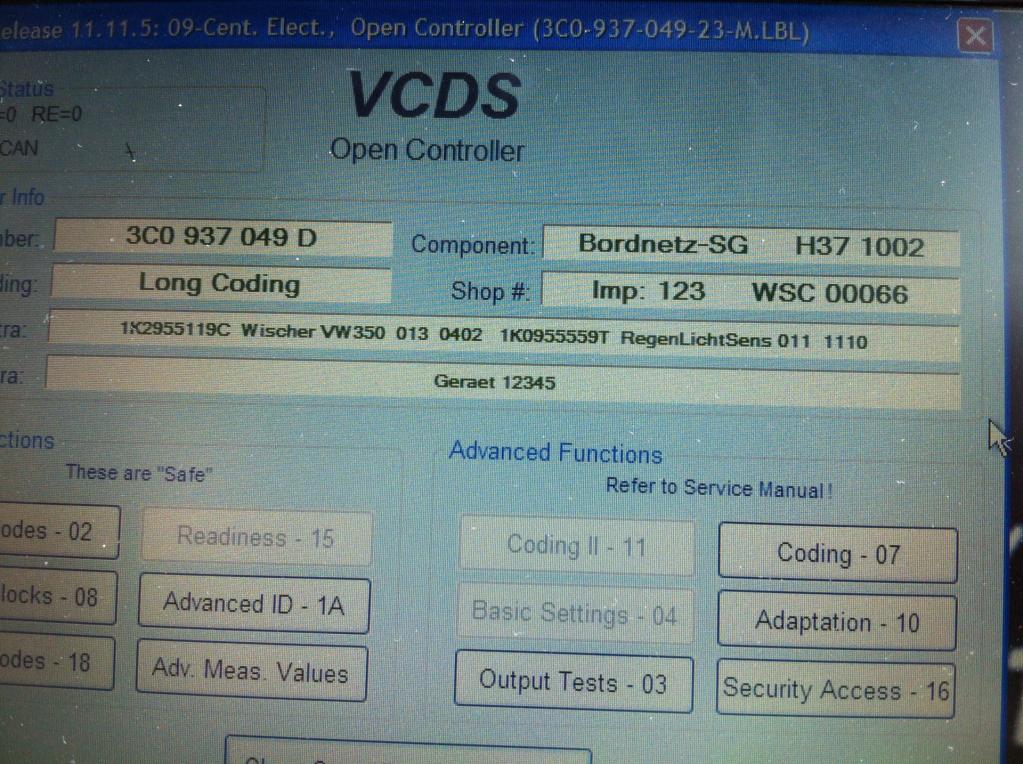

These are my scans
I'm thinking its the midline CECM, does anyone know the highline part number?
Had a play around with it this morning and with just ignition on the lights work fine but as soon as the engine is turned on the strobing starts, but I can fool it sometimes by turning the lights on before turning the engine on, a bit of a faff but will do till I can source a highline CECM.  :sad1:

Have found a list of 3C0 & 3C8 numbers that are highline but unable to find a list for 1K0 numbers, and typically the ones local to me are 1K0  :fighting:

OMEYDZ!!!!!! You my friend are a legend, thank you sooo much!  :notworthy:
Just simply adding 10 to my 4th byte sorted it, now it's all good
