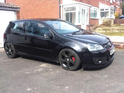

After getting my wheels refurbed and them turning out like this  :confused: :
I really need to get them done asap. Im going to buy myself a gun to go with my compressor and other needed bits to paint my wheels buttt, ive never done it before so i guess its about time i learn  :happy2: Been eager to learn and get my own gear for a while and i think its something i wouldnt be too bad at once ive learned it.
So im going to be painting 4 18" monza alloy wheels in a gunmetal grey, the centre peice of my ed30 splitter and my mirror covers in the same colour. I will also be re-doing my splitter in black magic as its taken a beating from stone chips.
Now im wondering if you guys can give me any advice on any tips/techniques down to exactly what im going to need for the job.

they look pretty good! They got refurbed less than 2 months ago so there already in great shape. So im guessing i just need to get rid of the lacquer and key the surface. No i will be doing it using a spray gun. Ive painted wheels before using rattle cans and it came out ok but i want to get a gun so i can do my splitter and mirror covers and finally learn. cheers
