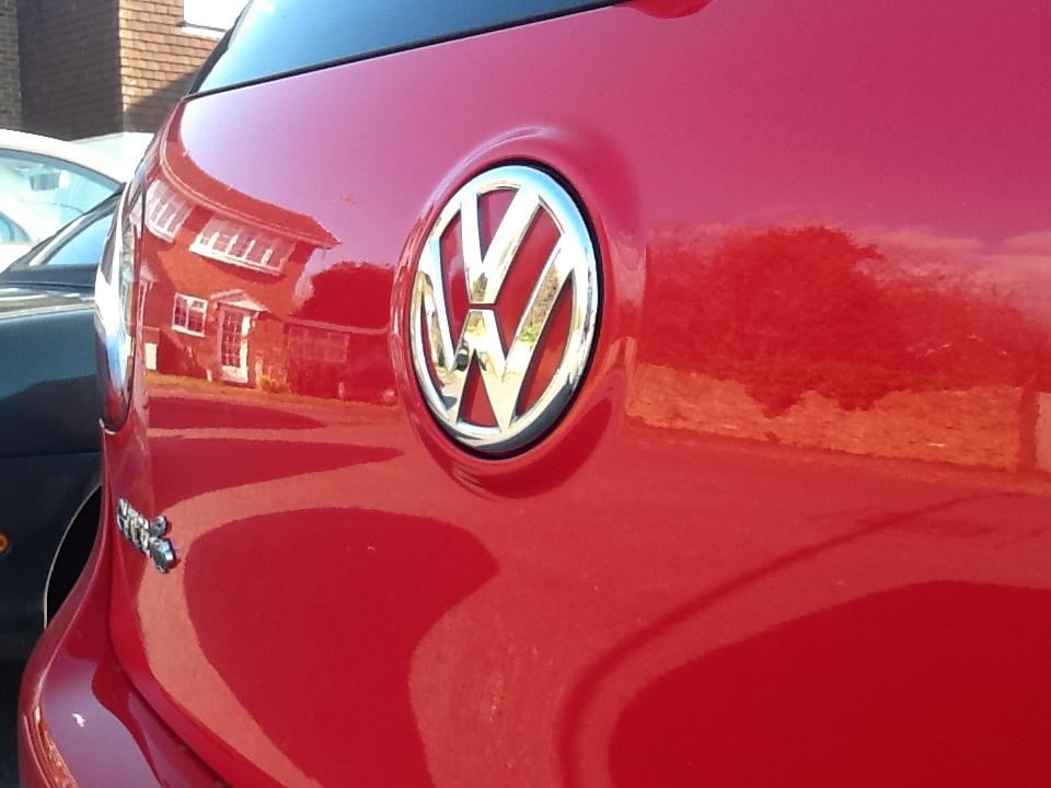

By the way MC71 what rear badge is that on your motor? Looks really smart!!

Re: Condensation driving me insane!!
« Reply #10 on: May 01, 2013, 04:52:29 pm »
Its a Mk6 one with a colour coded background.  :happy2:
