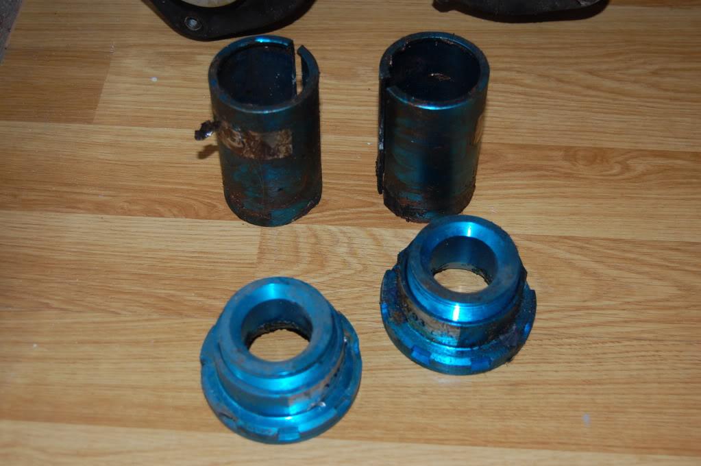

Jom's usually come with a 50 mm strut and a liner to slide into if you are fitting to 55mm hub

FYI, all the JOMs are 50mm and they come with an adapter bracket, as pictured at the top

All the GTIs are 55mm strut. Basically if your calipers say FS III on them then you have 50mm hubs (these are only on the 280mm disc cars, smaller engined vehicles such as the 1.4, 1.6 and 1.9 TDI. But this is not a hard and fast rule. The only way to verify is, as I said to check your brakes.
If your carriers are INTEGRATED into the hub (as in, non removable) then you have 50mm hubs.
