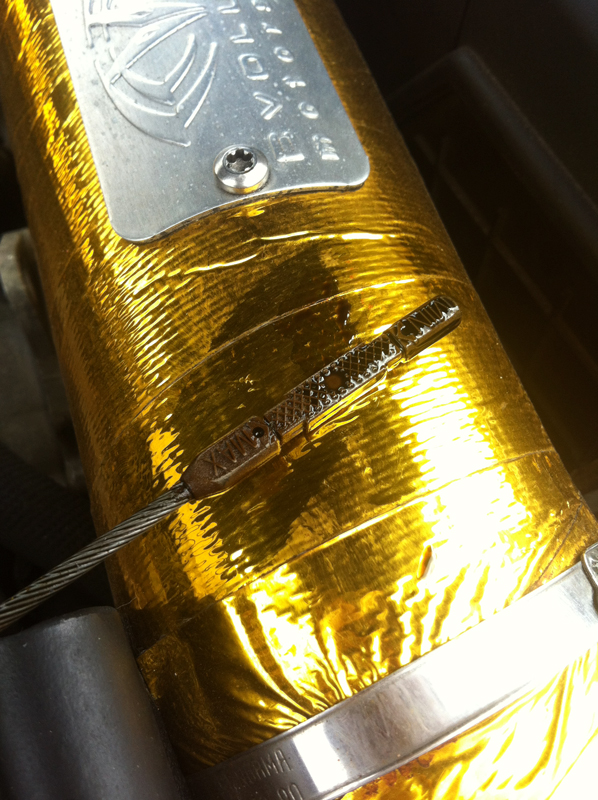

Re: Oil Use
« Reply #11 on: May 09, 2013, 12:37:03 pm »
Just check my oil... engine running and nearly shat myself as it looked like it was empty!  :scared: :scared:
Got home and parked on the level... engine off, and there is some oil in there  :jumping:
Ive done ~8000 miles since it was last serviced and the oil changed.
Here is the result.... ive not put a drop in since.
