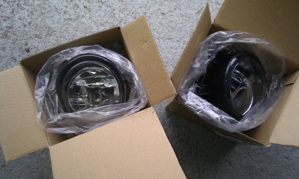

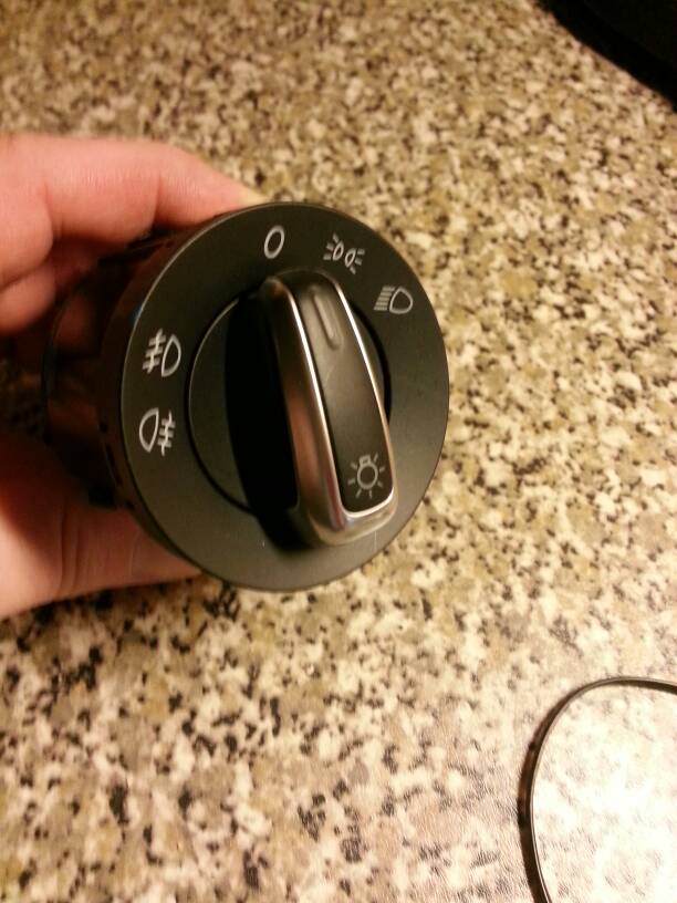

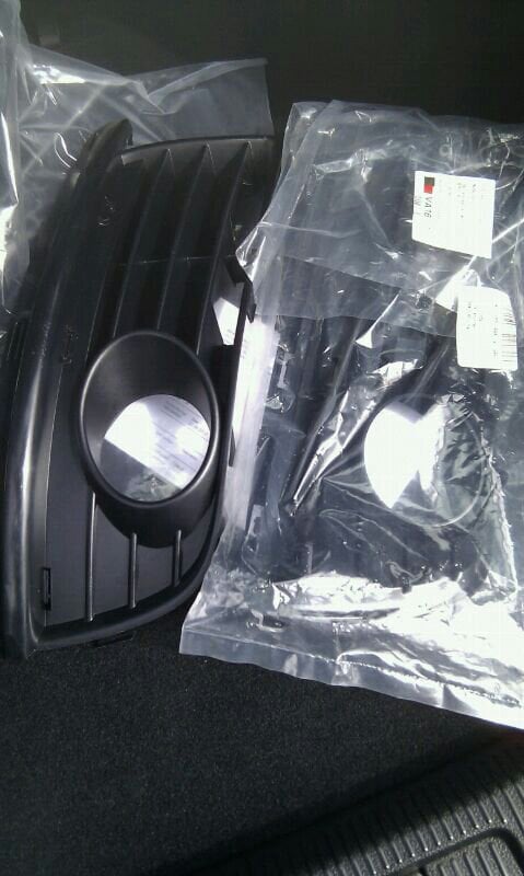

These are reflector type I got
Genuine grills

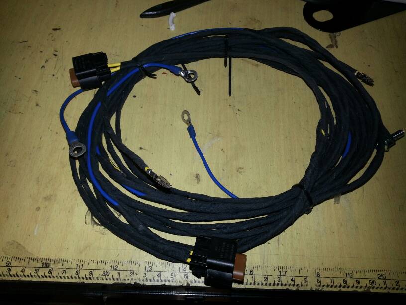

Loom I had made up
Mk6 light switch

Well the loom I had made was for hb4 but I fitted later reflector type lights and they were h11 ...if you ring vw and ask what bulb should be fitted to your car with optional fogs fitted they will tell you what should be in as standard then you can order loom to suit

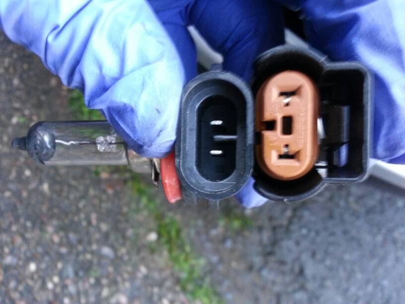

think i got it if you look at the bulb holders the pins are close together with h11 and far apart on hb4 is this right buy yours

H11 on left (small) hb4 on right (spaced further apart )
