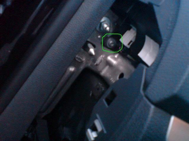

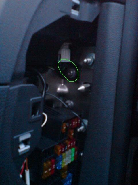

I have recently been getting a few rattles in the dash and so i decided to investigate last night. I found these two screws completley loose and ratteling. Others may be the same so go and check it only takes 30 seconds to have a look,
to remove the panel, slot your key in the hole at the bottom.  :happy2:
HTH  :smiley:

also could be the rear seat belt on the plastic, try plugging them in and have a go.
Sorry for being stupid - but which panel are we referring to??
I also have a little rattle somewhere in the centre console - I think its the inder the tray with the bottle opener or somet, since it seems to go when I put some pressure, or somet heavy, in the tray...
The one that covers the fuse box, and then the same on the other side.  :happy2:

I took the cover off my fuse box and the passenger side today and both the screws were loose/rattling round so i tightened them up, nice one joe  :happy2:

Both my screws were loose, causing a slight rattle too. Quick 5 second fix for an annoying noise.
Two screws, where?  And does VW have a problem tightening screws?
Offline Deako
  • -Given: 38
  • -Receive: 44
  • Posts: 1655
  • Eat, Sleep....VAG
Re: a quick tip for ALL MK5 OWNERS!
« Reply #13 on: August 12, 2009, 08:53:56 am »
The 2 screws mentioned above.  :signLOL:
