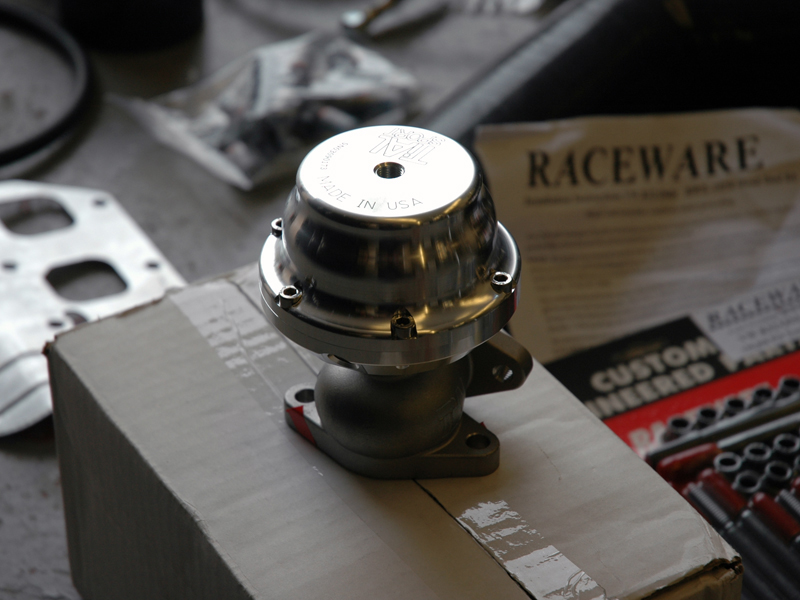

It started with the importing of the kit, for which Regal are now distributers.
which has a Precision Billet 62 Dual BB Turbo
and 38mm Tial external wastegate
Its the Stage 2 Kit so includes....
Cast Exhaust Manifold
3" Stainless Steel Downpipe
Tial 38mm WG
Front Mounted Intercooler 22" x 8" x 3.5" Bar and Plate type that keeps all factory grilles and bumper
SS 3" Mid-Pipe Kit
3" SS Hi-Flow Cat
SS Intake Piping
C2 Performance Software
Larger Injectors
Injector Harness
4" Open Element
"The Bat" 4" SS Intake w/MAF
Diverter Valve
All Necessary Silicone
SS T-Bolt Clamps
SS Braided Oil Feed/Return Lines
Oil Fittings
SS Lowered CR Head Spacer
Raceware Performance Head Studs
but we will be adding a C2 Fuel Pump Kit and an electronic Boost Controller along with software alterations to suit in the future to develop more power.
The objective with this car is to make a UK specific kit and see what power is possible with it in the uk. There was a packaging issue in the engine bay to overcome so a number of things had to be altered from the US spec kit. This has now been done and the car is finished :)
