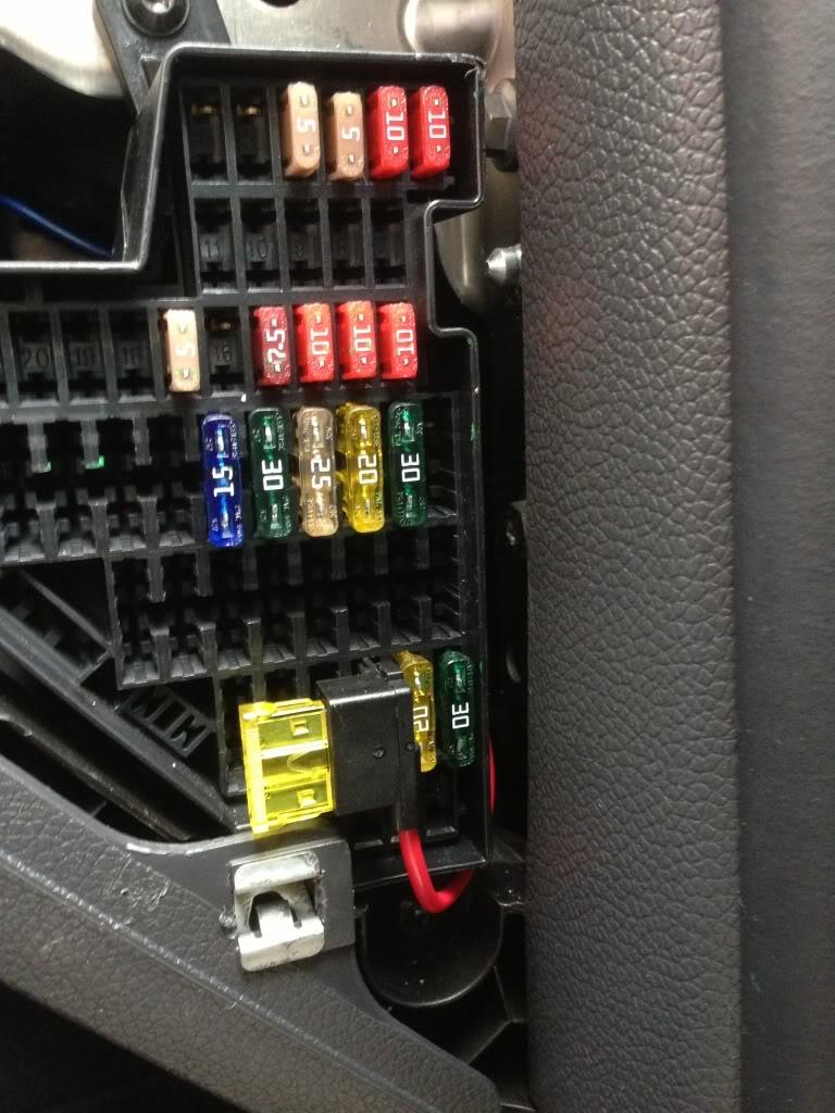

You want to run a wire from the switched live at the back of your head unit (pretty sure its normally yellow). I used the 12v remote cable you get with an amp (just make sure its the same thickness). After you've done that you want to use one of these (
http://www.ebay.co.uk/itm/ADD-A-CIRCUIT-FUSE-TAP-PIGGY-BACK-BLADE-FUSE-HOLDER-/321088781277?pt=UK_CarsParts_Vehicles_CarParts_SM&hash=item4ac261fbdd
) and run the cable to it. You then want to use a voltage meter to test your fusebox for a 12v that only comes on when the ignition is on. Once you have found it simply pop the fuse tap it and you're good to go. It shoud look like this once you have done.
