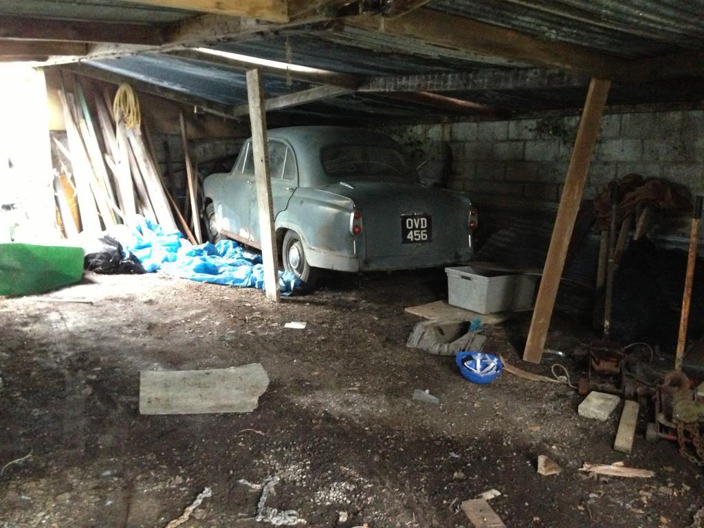

Been rooting round the girlfriends grandads garage for these all day, sorting them for sale...
Anyone got any ideas on getting that last one out?! Brakes are seized... And we can't tow it out because its in a corner.... Ideas please!!

4 trolley jacks?

The car that you want help with can you walk around the side next to the wall Even if it's abit of a squize?

http://www.machinemart.co.uk/shop/product/details/awd1-automotive-wheel-dolly-pair

Yeah you can get all the way around it... Gonna have a go at giving the drums a good hit first

Yeah that was what I was going to say, remove the wheel and give the drums a good hitting. I did that on a Nissan navara that had been sat in a field for years and it worked.
