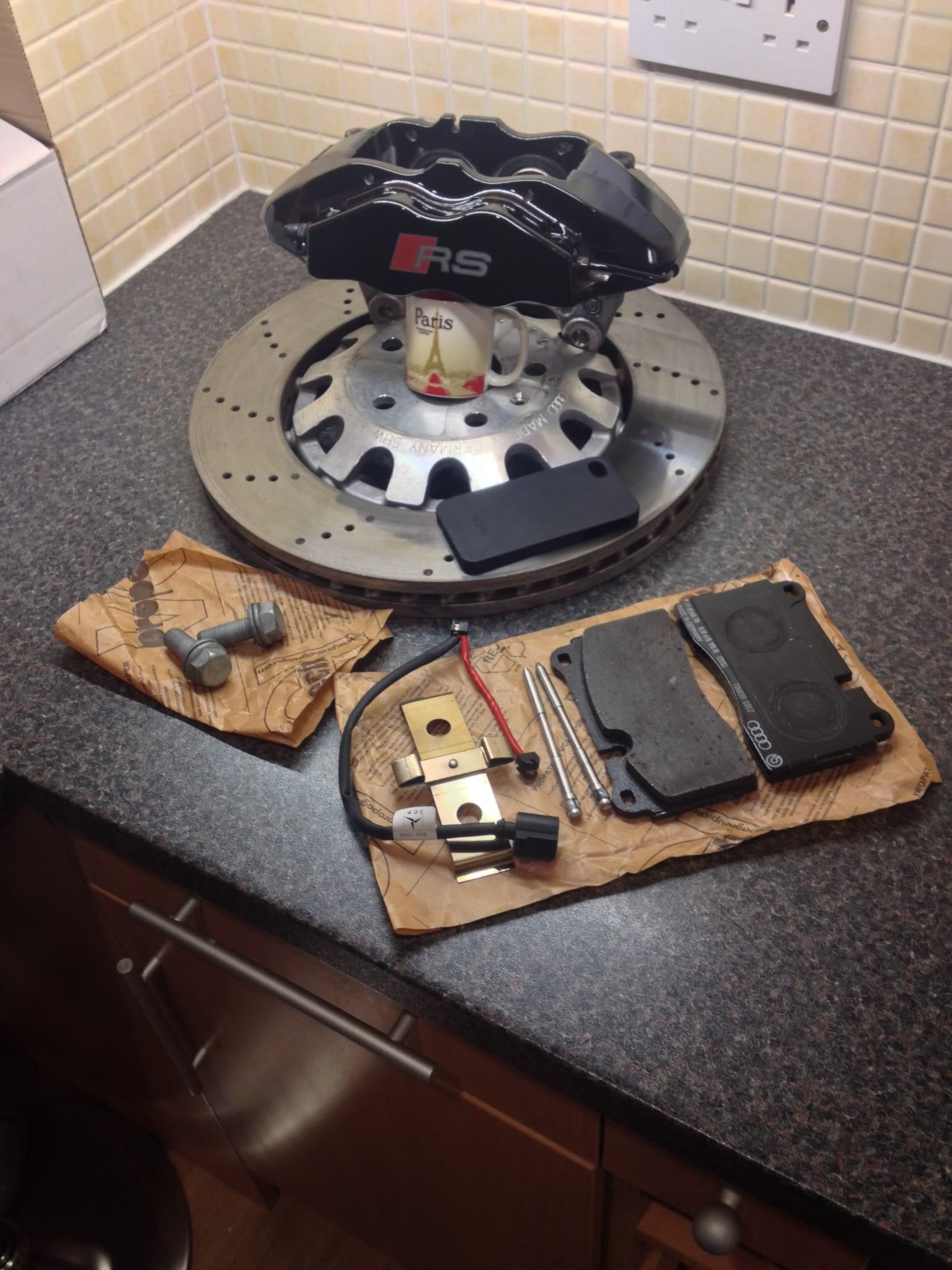

New brakes to be fitted soon at AKS  :laugh:
Hopefully no spacers needed with my CK's but I know ill need em with my O.Z track wheels.

 :notworthy: :notworthy:very very nice Carlos..been looking at these brakes for mine but wasn;t sure about them fitting behind the ck,s

Cheers mate, I'll let you know how they fit behind the CKs  :happy2:

Ttrs discs carlo???
Re: Monte's RS Edition30 DSG (new Vinyl Wrap pg6*)
« Reply #140 on: October 07, 2013, 07:11:22 am »
Yes mate  :happy2:

The brakes are lovely

You are gonna need a spacer pal
« Reply #143 on: October 07, 2013, 08:57:21 am »
For the CKs Gaz?
If so what size?  :popcornsoda:

Yes the CK's mate, Well we get away with it on mine because I run daveb disks and brackets which move everything 12mm inboard, I get about 6mm clearance, so by my reckoning a 10mm spacer would give you 4mm. We have tried the CK's on another lads S3 with the ttrs discs and they wouldn't fit. Have a look on vagoc mate there is quite a lengthy thread on there about what fits and what doesn't

Oh Poop  :sad1:

have a look at that thread on vagoc mate, might even be worth a pm to DaveB, anyway I can help just shout up :happy2:

Your new brakes get me a little too exited  :laugh:
I didn't want to do too much to my Ed30 but yours gives me bad ideas......

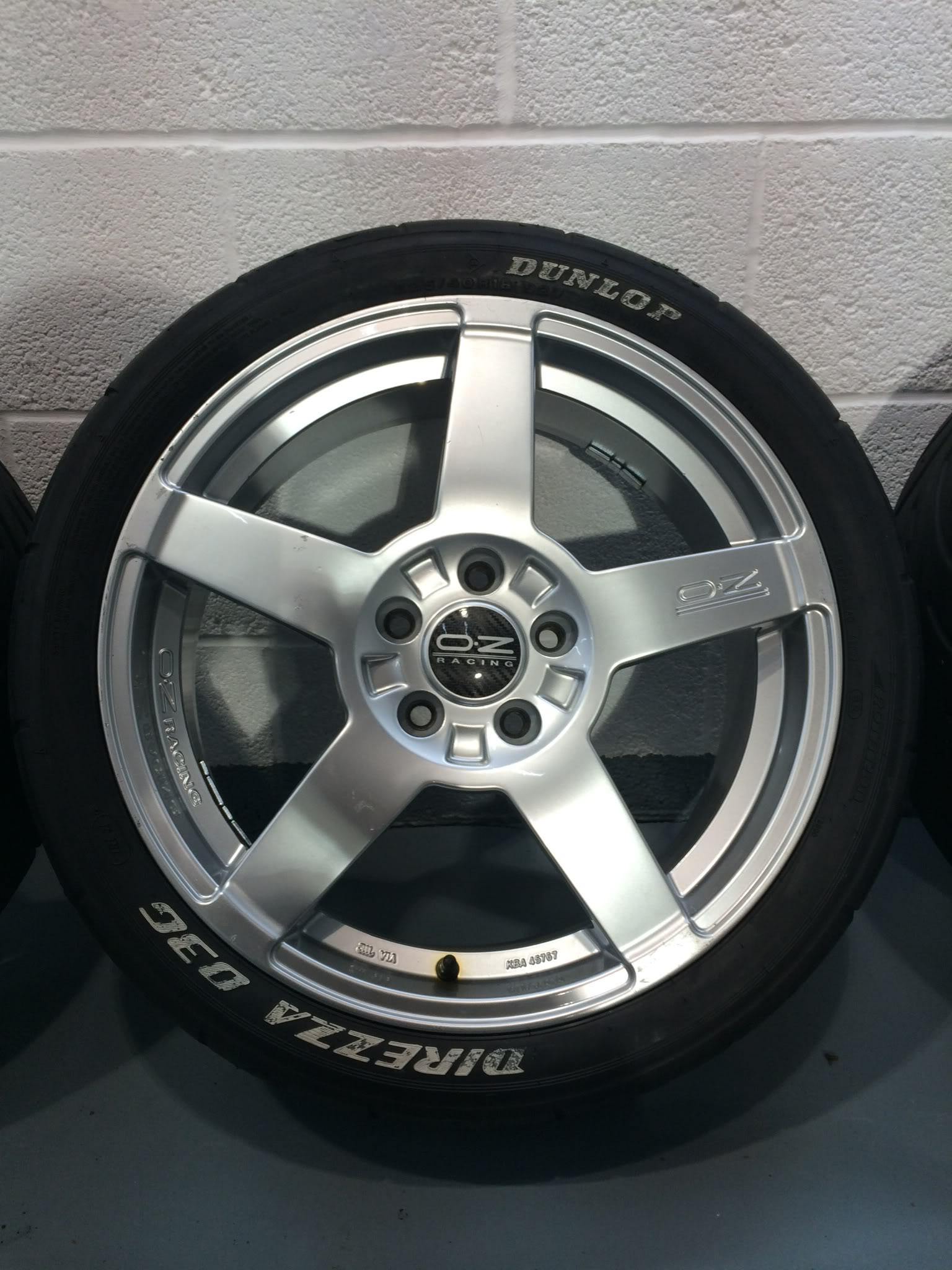

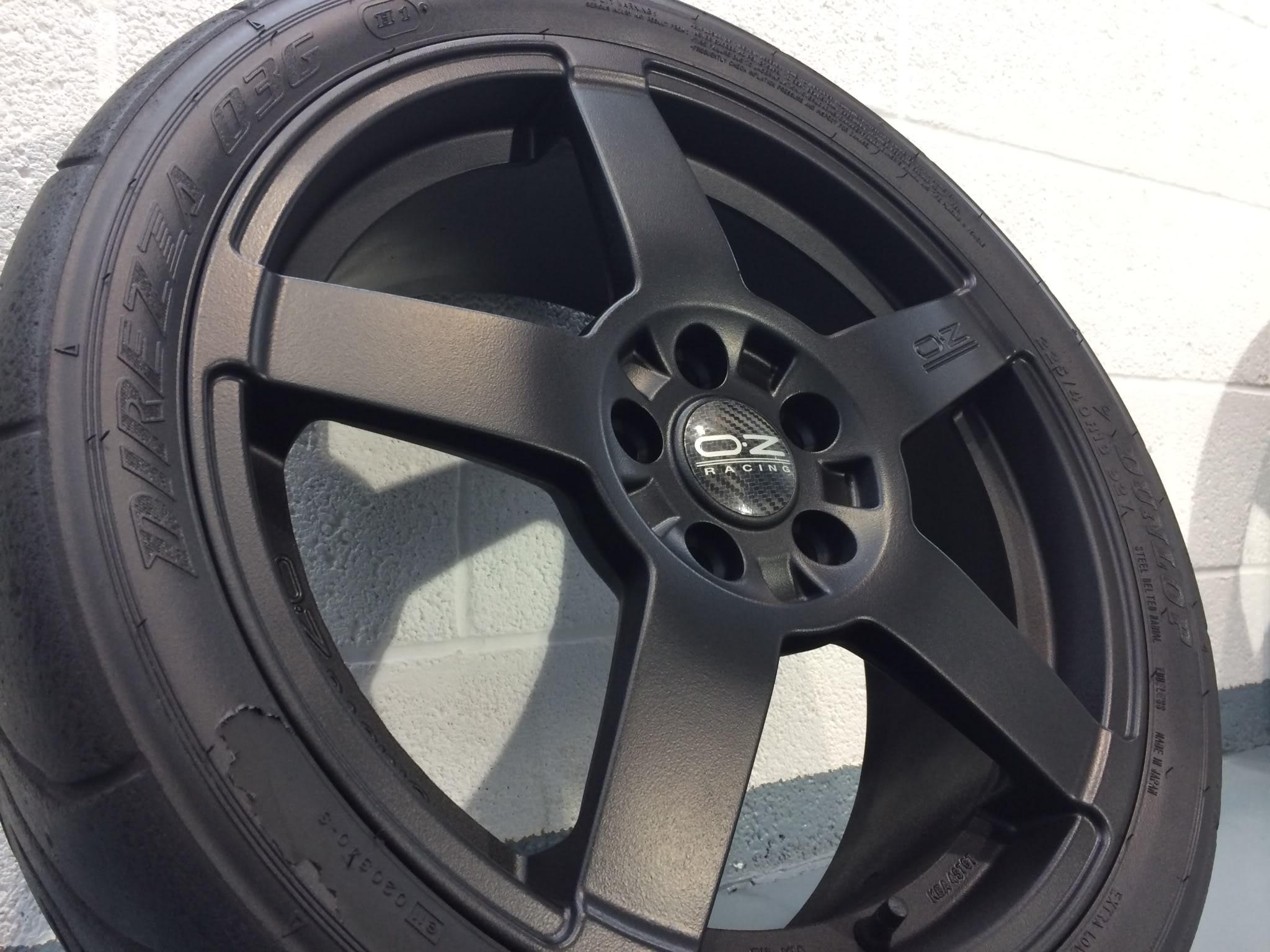

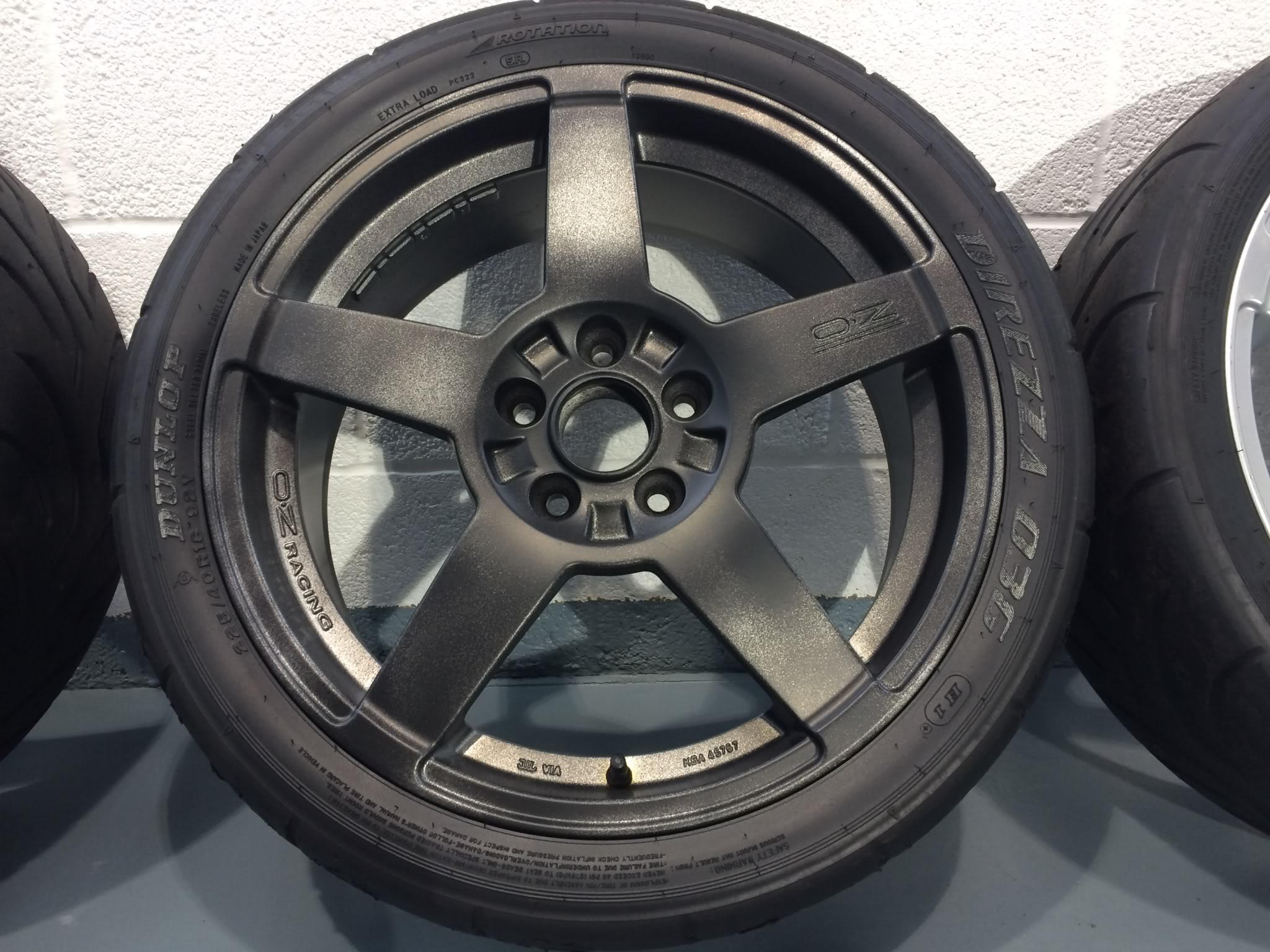

Well today I sprayed my Track wheels. (Well I made a start)  :innocent:
I decided to give Plastidip a try after I'd used it on various badges. The process is very very easy. A good clean and a wipe down with IPA is all the prep needed before spraying. No sanding needed. :notworthy:
I'll be finishing the rest tomorrow and then on Wednesday I hope to get them on the car for some photos  :smiley:
I'm really impressed with the results so far.  :drool:
Before:
After a light coat:
One wheel finished:
