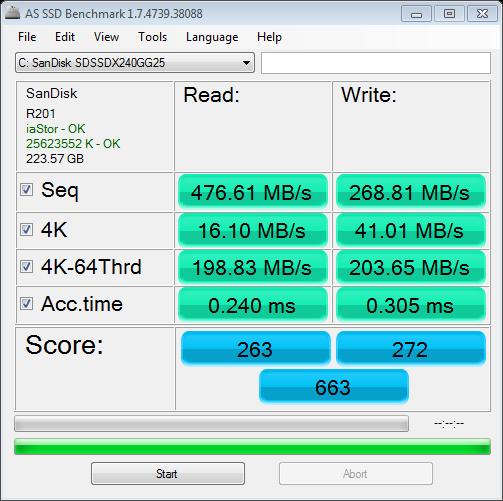

I was under the impression that if you just clone the OS from a spinning platter hdd to a ssd hdd then the OS will be out of alignment and affecting performance.
Easiest way of checking the alignment in a Windows environment is to start up AS SSD benchmark program. If the alignment is off it will say bad in the top left corner and ok if correct. You don't have to actually run the benchmark test, just open the program.
