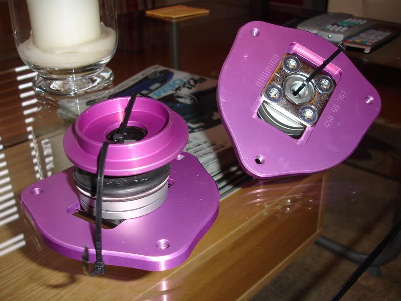

KW camber adjustable top mounts

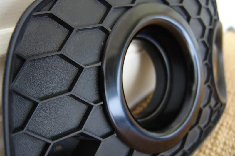

Custom cold air feed using a 102mm inlet (picture shows 76mm inlet)

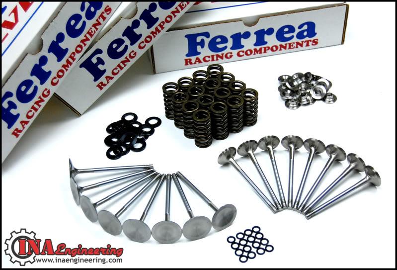

  • Supertech pistons - 82.5mm bore / 9.1:1 CR
2.0T FSI ARP 2000 head bolt kit
The OEM cylinder head will be ported and polished and installed with a stock size Ferrea valve train kit..
Ill be running stock cams for the mean time.. The current offerings available have yet to prove there worth, so im working on some other options that will be considerably cheaper and more effective..
Im not quite decided on which way im going to tackle the engine build, I may just build the motor thats in the car, or possibly buy another ED30 motor and build that, either way it will be done around March this year, which will be in time for the weather improving (hopefully) and the up coming show season in the UK..
The engine build parts will make for a motor good for well over 600hp crank HP and will be capable of revving to 9000rpm without a problem (Ferrea have tested the valve train to 9800rpm)
Thanks to Issam @ INA Engineering for the engine parts!

So Jonny, You have moved the intake to the left? Have made another cold air feed from the left fog grill? or are you using 2 cold air feeds, one from each foglamp grill? would it be of any benefit to have 2 air feeds?
Not yet, but Im in the process of doing the intake.. Its being welded up tomorrow so fingers crossed Wednesday I can get the car in for all of the work before Santa Pod.. (not including the engine build obviously)
Im moving the washer bottle to make room for a hose to feed the filter, and ill just run the cold air feed from the driver side fog grill yeah..  :smiley: I really doubt it would be of any benefit having two, im sure I can get more than enough cold air into the filter area with just one feed.. Plus, it would look pretty scrappy running one from the other side too..

[quote/]
[/quote]
Could you help me with a link to where these are available from??  :happy2:
Over the top mod list ;o)
