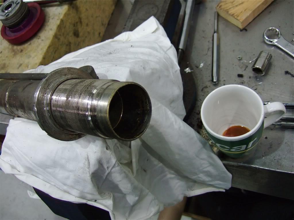

There really wasn't anything meaningful to photograph when I was there on Thursday, except this! : -
^ Water which was in your damper!

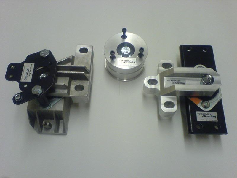

I also had the VWR 'Race' lower engine mount fitted, this is amazing, for sure its not for everyone as its completely solid, so the vibrations are a little harsh on pulling away..
Picture shows the 'road' gearbox and engine mounts and the 'race' lower engine mount, there is a 'road' lower engine mount but as I already had the full VF engineering kit this wouldn't have really been a big step forward.
The fitting is a little more involved than any of the other lower engine mounts, the intermediate sub frame is dropped and the old insert is pressed out, then the new solid aluminum mount is pressed in.. there is ZERO movement now, the car is now amazingly precise and responsive on throttle, and forget about any wheel hop!!!

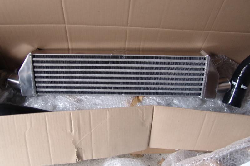

I had a Forge 'Twintercooler' kit delivered to VWR but unfortunately there wasn't quite time to fit it.. Its amazing piece of kit, really great finish, and from all of the reports I have read its going to make the car run much cooler, which should make some great increases in power and torque throughout the rev range! Ill write another update once I have this fitted, should be this week as I need it for Santa Pod this Sunday!!
I went for the black hoses to keep the subtle look. That core is going to look amazing behind the middle grille!! Very mean!!

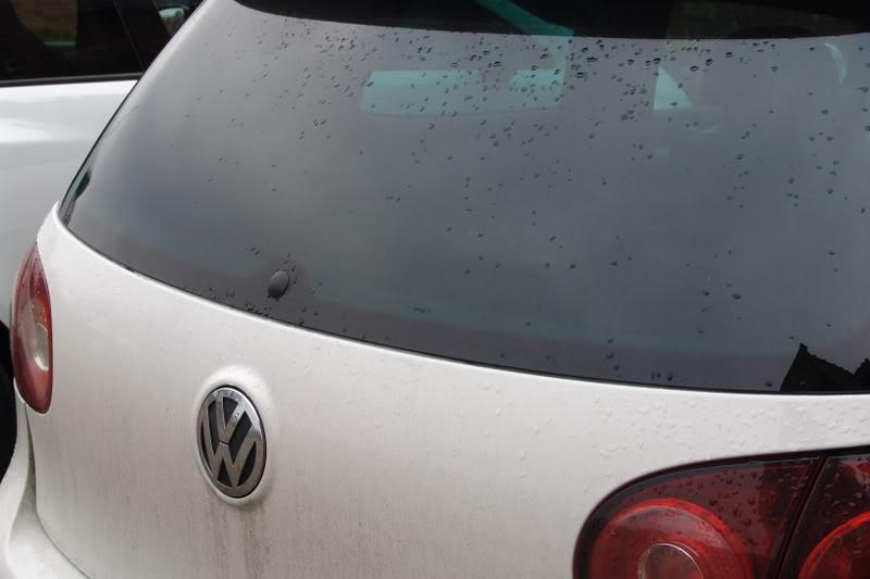

The last few things that I had done at VWR was to remove the rear wiper from the car, this was for a couple of reasons. One I really like the look of it, makes the rear end much cleaner! And two it saves a bit of weight! Then I had the rear bumper bar removed, this is a really heavy steel bar which sits behind the rear bumper, it would prevent the bumper from cracking in a little hit, it plays no part in safety from rear impact etc, if it did then I wouldn't have removed it.. It weighed in at just over 10kg's so well worth removing!

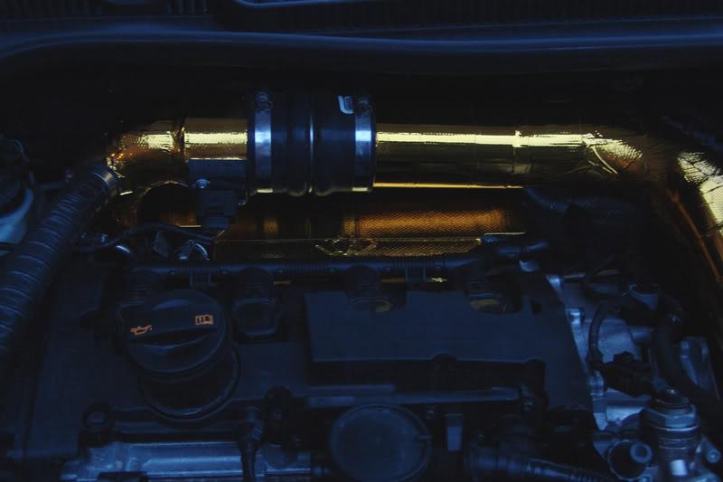

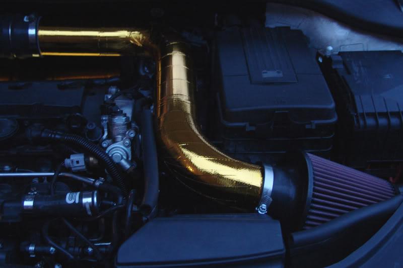

Oh! And.. Got myself a little more of the Gold heat tape and finished off the intake pipe! A custom heatshield is being made as we speak which should feature a bit more GOLDD! And im having a venturi cold air feed from a set of open fog light grilles made up too.. This should keep the filter nice and cool, and away from the radiant heat of the coolant pipes that it currently sits above..

jonny, is removing the rear wiper an easy job? also whered you get a bung to fit?

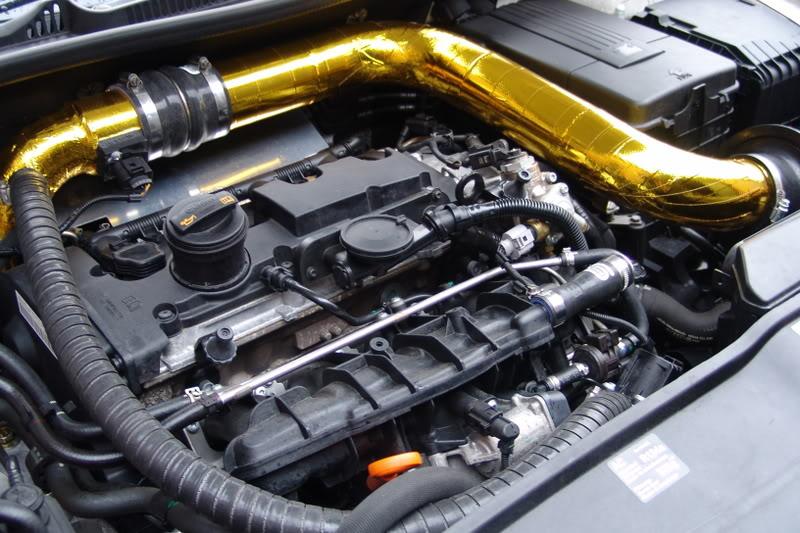

Update..
Hey all..

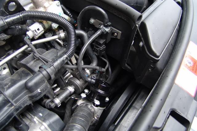

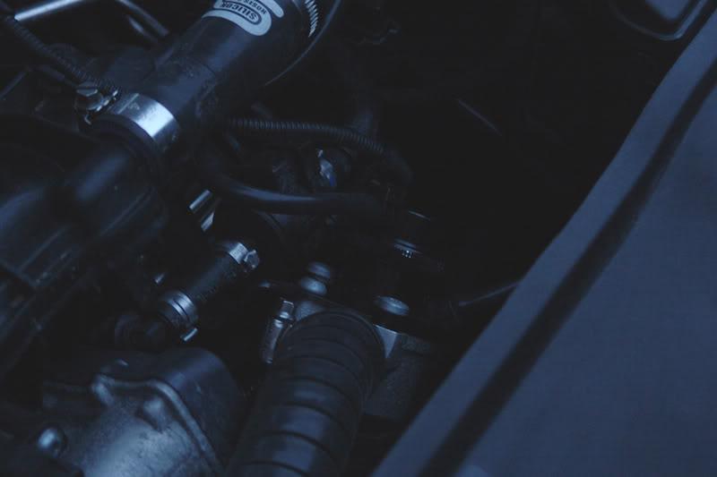

Parts for the Forge DV arrived this morning so I thought I would install it today and whilst I was there sort out the MAF heat shield and make a filter heat shield while I was at it..
I already had an Evoms heat shield sat in the garage, and after a lot of cutting up I managed to make it work with the custom intake system on my car, I'm pleased with how it fits now! I also used it as a mounting point for the N75 valve from the Forge DV, keeps it out of the way and looks nice and neat..
(This is a pic from when I had the Forge DV on my S3, I have mounted the N75 valve in a similar way)
Once that was done I turned my attention onto the filter heat shield, as I said it required a lot of playing around with to make it fit, but now its in, and solid..
Then I thought that I would neaten up the MAF heat shield. First of all I cleaned it all up and then wrapped the whole heat shield in Gold heat tape, apart from looking good this stuff really works well at keeping the heat out of where you dont want it!!
After a drive out in the car it definitely feels stronger as a result on the Forge DV being installed, seems to pull harder mid range and the throttle response has improved also. There was nothing wrong with the standard DV on inspection but for sure IMO the Forge DV holds boost more efficiently and as a result the car is even more mental than before!
Also all of the work with the heat shields now means that after a 30 minute blast everything was cold to the touch.
The finishing touch to the intake will be a 76mm Venturi cold air feed routed from an open fog grille on the passenger side, directly to the air filter..
I also have my Forge 'Twintercooler' to fit, then its going to be super cool!! Should really make a good difference!
On a side note has anyone installed one of the forge twin coolers? How long did it take you? Easy job?
Thanks
Jonny

Im pretty sure it is yeah. It was done whilst the car was in at VWR though.. They had the bungs and did it all for me  :happy2:

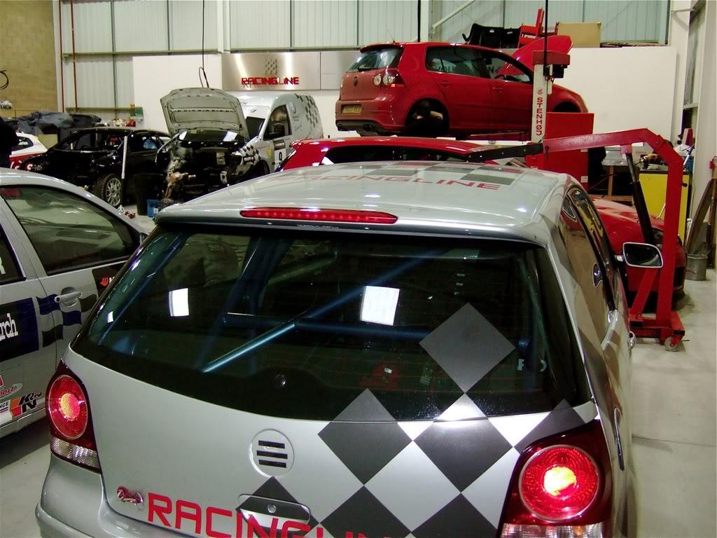

....I think that VWR did it for him [Jonny just confirmed this ^]. Rear wipers aren't needed on race cars. Personally, I wouldn't want to be without a rear wiper on a hatchback for road use but ETTO.

What's that scruffy 'pink' car doing on the lift?  :laugh:

ive installed the S3 cooler on my gti, took me about 5 1/2 hours but i think i could do it in about 4 now. its pritty straight forward, front bumper and grill can be off in 15 mins, then its just taking you time and following any instructions, and also keeping track of all the screws that you take out  :ashamed:
i think the twintercooler ill be quicker(easier) than the S3 one as you will be keeping the std cooler. so not as much work. but if your doing this (and you obv aint strapped for cash) why not combine the S3 cooler with the forge twintercooler. they youl be verry cooooooooooooooool :scared:
