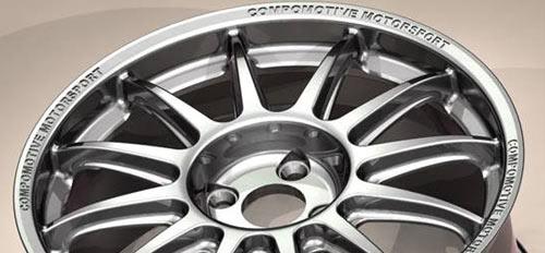

The first big thing that I want to get sorted out is traction, the 235/40/18 R888's are working well for me but for sure there is some more to come in the 60ft times and it would be awesome to get a bit more rubber on the car! It would also look pretty awesome!!
The plan is to have a set of 18x8.5 wheels made up (im going for the Compomotive MVS 1885) Its quite a nice looking wheel, light weight at just over 9kg and they will make the wheel in any offset you want, so I will be able to get them just right!!
Plan would be to have them finished in Matte black..
Then and fit a set of 255/35/18 (260mm wide) Toyo R888's tyres to them, this will give me an extra 16mm contact patch per corner, so 64mm in total! A pretty substantial increase over the 235/40 (244mm wide) R888's that im running currently..

Its going to be a fair bit of work to make them fit but I think it will be worth it in the end, and im hoping this should really help out with traction off the line and throughout 1st gear..

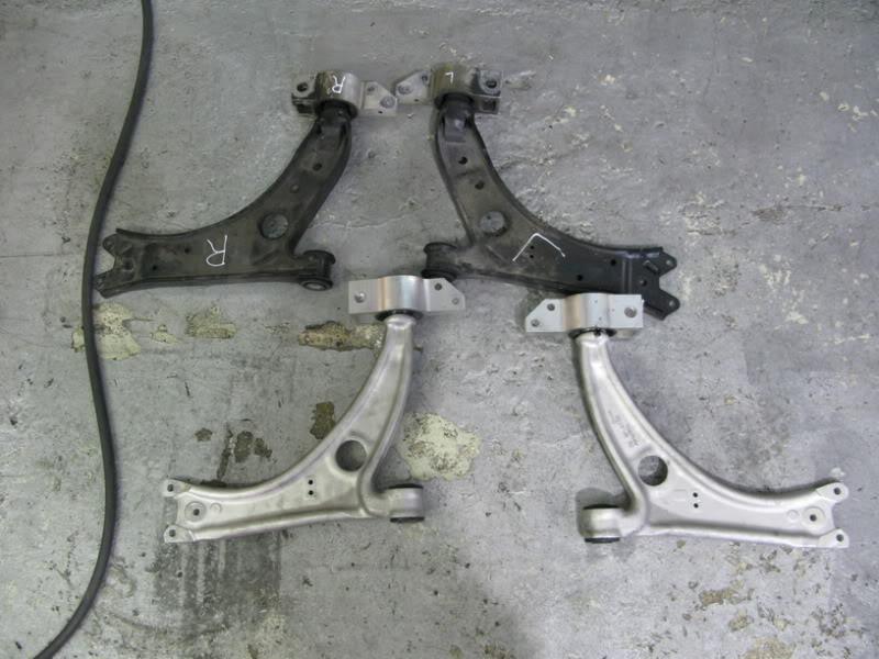

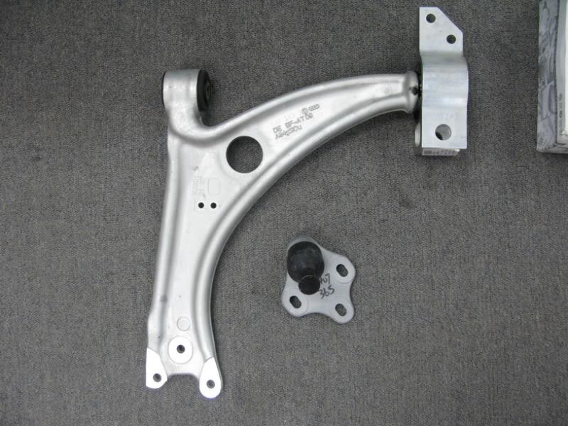

Ill be replacing the front bottom arms with OEM TT items, these are not only lighter (aluminium rather than steel) but they also offer an additional 0.5 degrees negative camber for the front end, so I should be able to run around 2.7 degrees front static camber and keep all of the caster I have too, looking forward to these!
TT arms..
Compared to stock..
They will also be fitted with the WALK and poly bushed rear bushes at the same time.. 4kg lighter than the stock items apparently too!

Thats just a pic from the net, there not for sale in the UK for a while yet..
Also the pic of the wheels is the same, they are someone else's wheels, mine should be all ordered up tomorrow!! :laugh:
