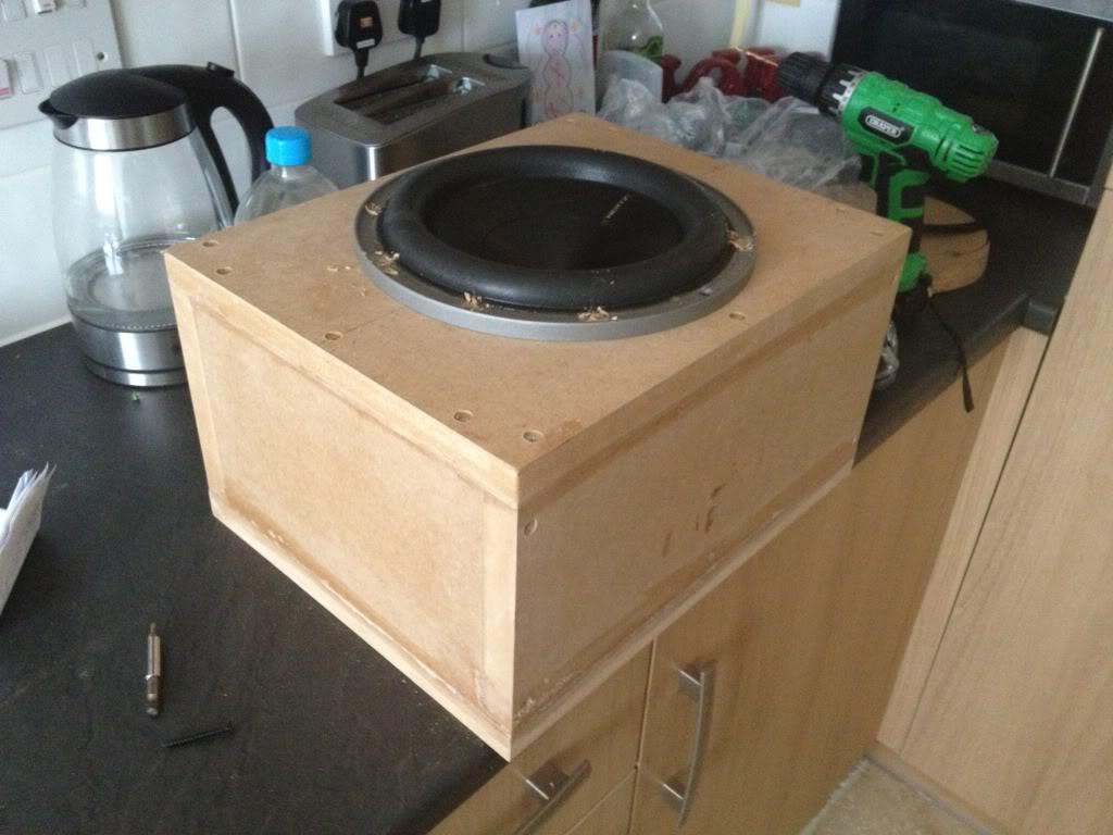

3 way fronts. 2 way rears. Sub in boot alcove on the left. Amp under the seat. Rear view camera.

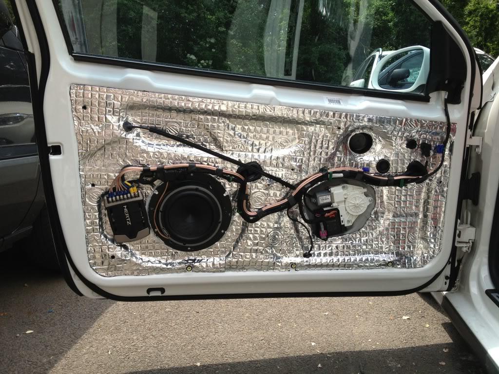

« Reply #21 on: July 04, 2013, 11:35:51 pm »

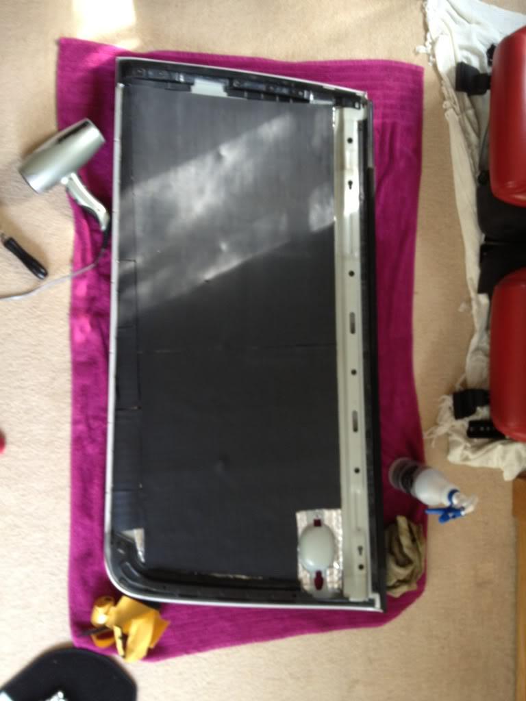

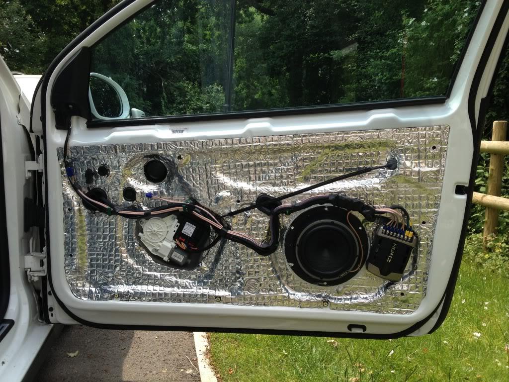

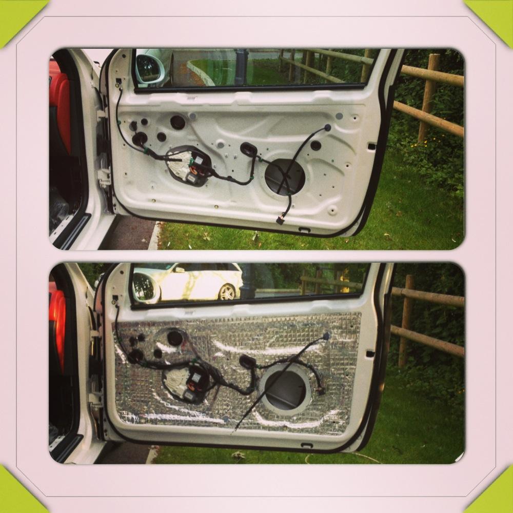

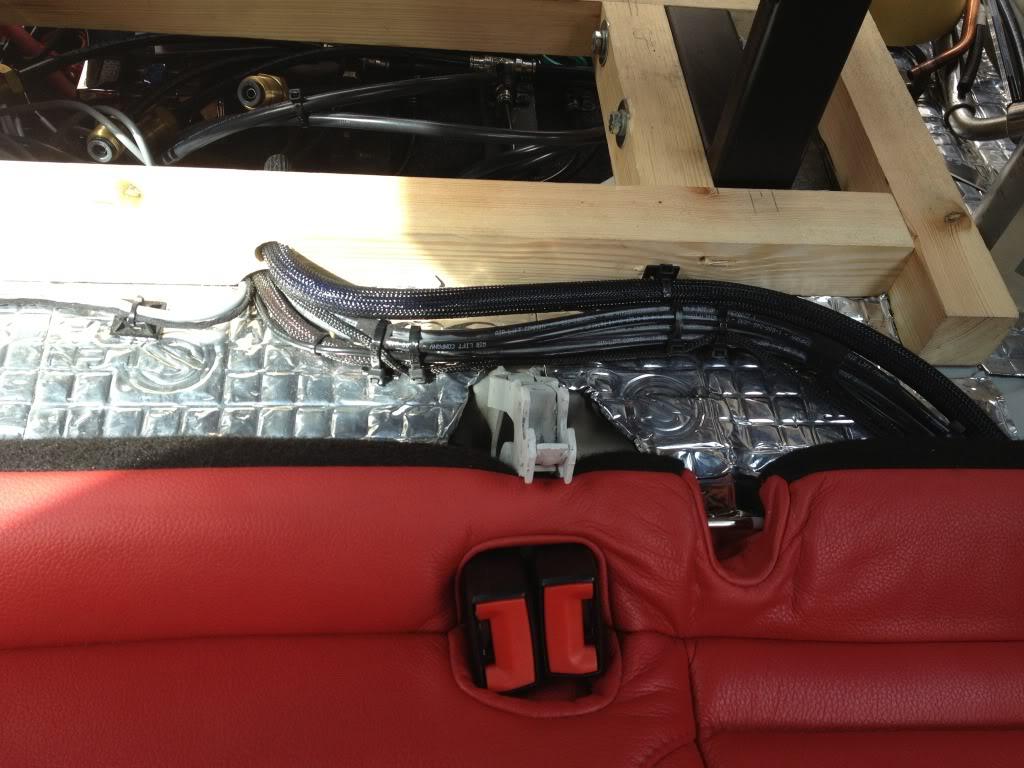

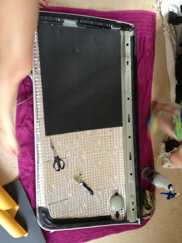

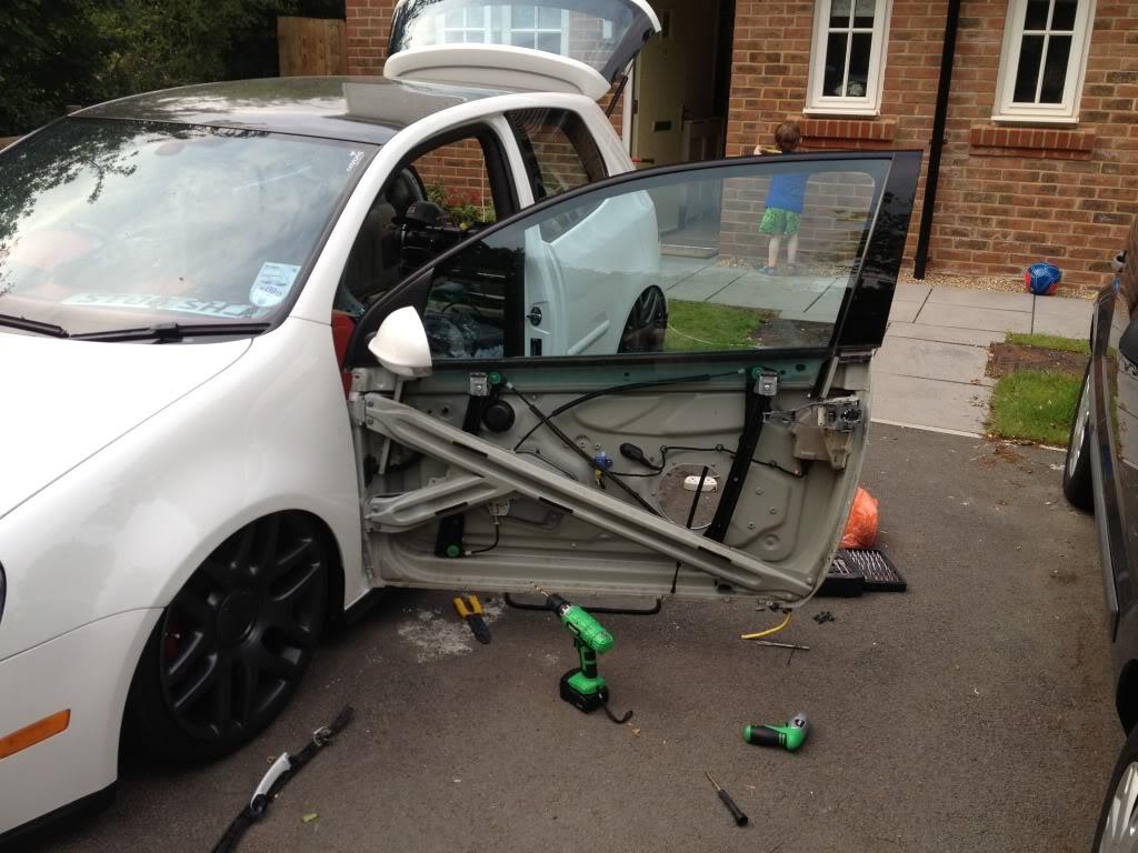

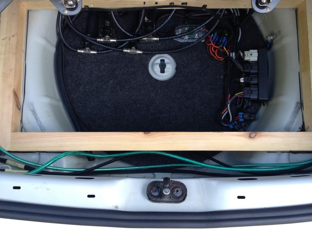

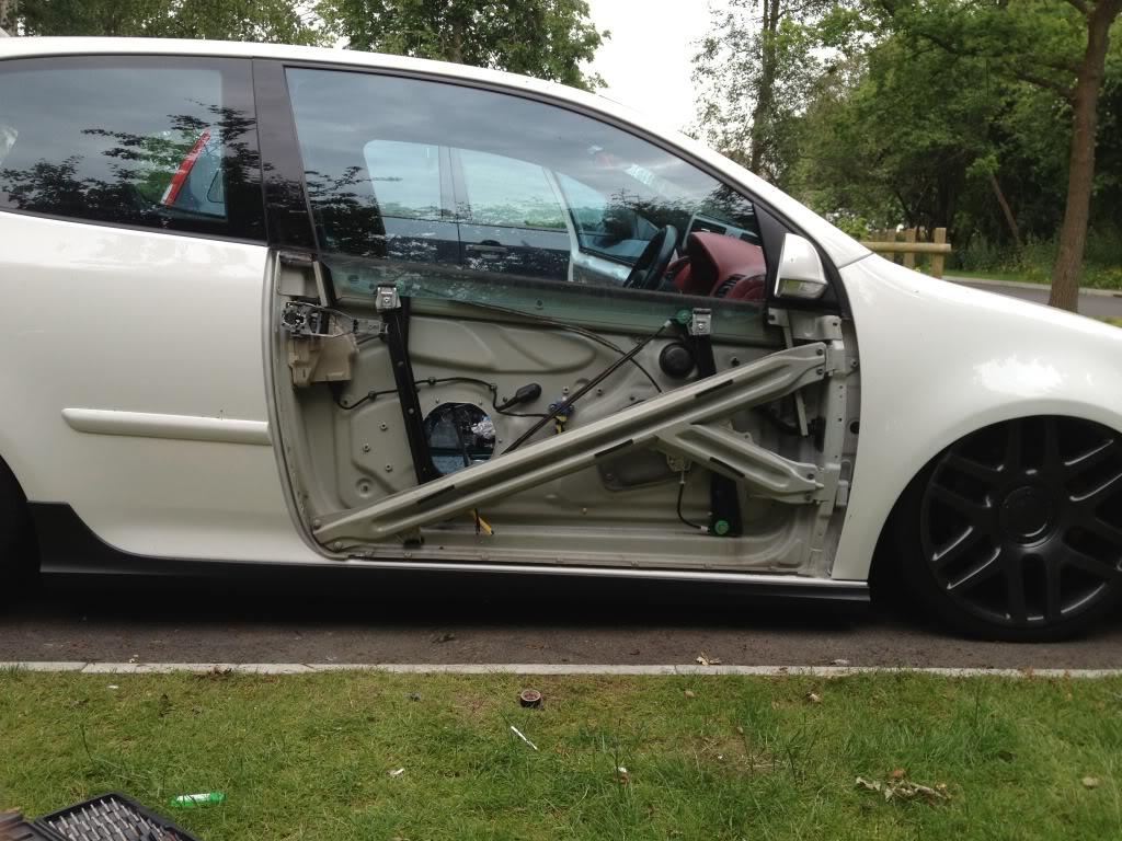

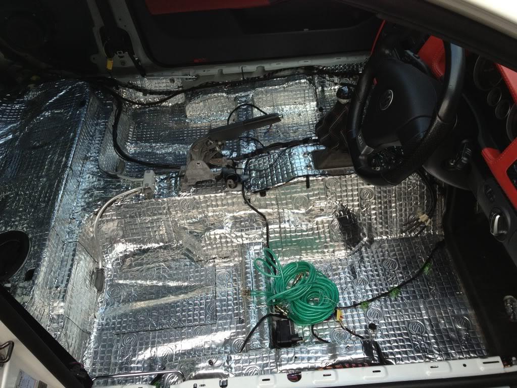

took me about 2 weeks but mainly because I kept coming across things I needed and waiting for them to be delivered. I sound deadened the whole floor throughout the car, sound deadening, noise isolator and acoustic foam along the whole sides of the car, inner and outta door skins. braided all the cables throughout aswell bar the ones from the crossovers as I'm eventually going to be running the front components active so will be ditching the crossover. Looks really good even though you cant see any of it lol.
I've still got to sound deaden the whole boot area and tailgate and modify my false floor so only the face of the sub will be shown and everything else hidden. Hoping to get that done next week

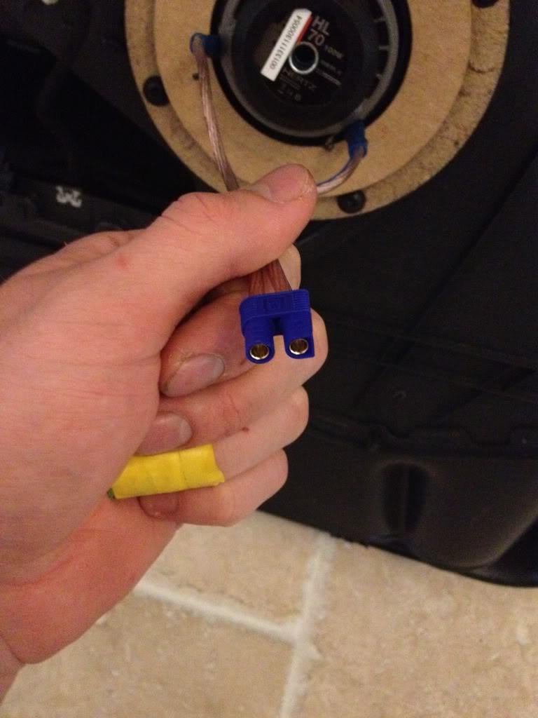

Used these connectors for all the tweeters and the front mids as recommended by Squeeguk (COPY AND PASTE THIS LINK AS ITS NOT WORKING FOR SOME REASON, sorry for shouting :) )  http://www.modelsport.co.uk/leads-connectors/rc-car-categories/9920/992045&MSAttributeID[39]=638&MSAttributeID[40]=1043&ManufacturerID=1174
Used 12 gauge cables for the front speaker runs and 14 gauge for the rear, 12 gauge for sub. I took pictures of nearly everything I done. I'll get some uploaded and post them up

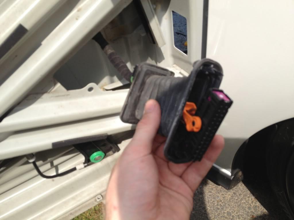

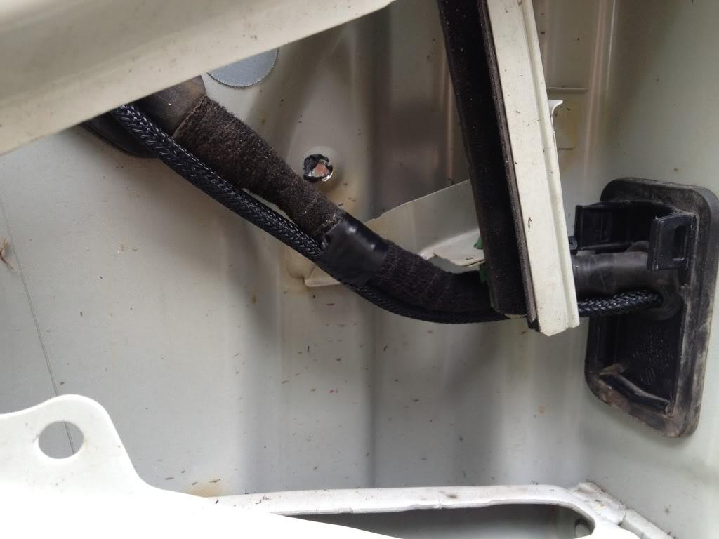

« Reply #22 on: July 05, 2013, 12:04:01 am »

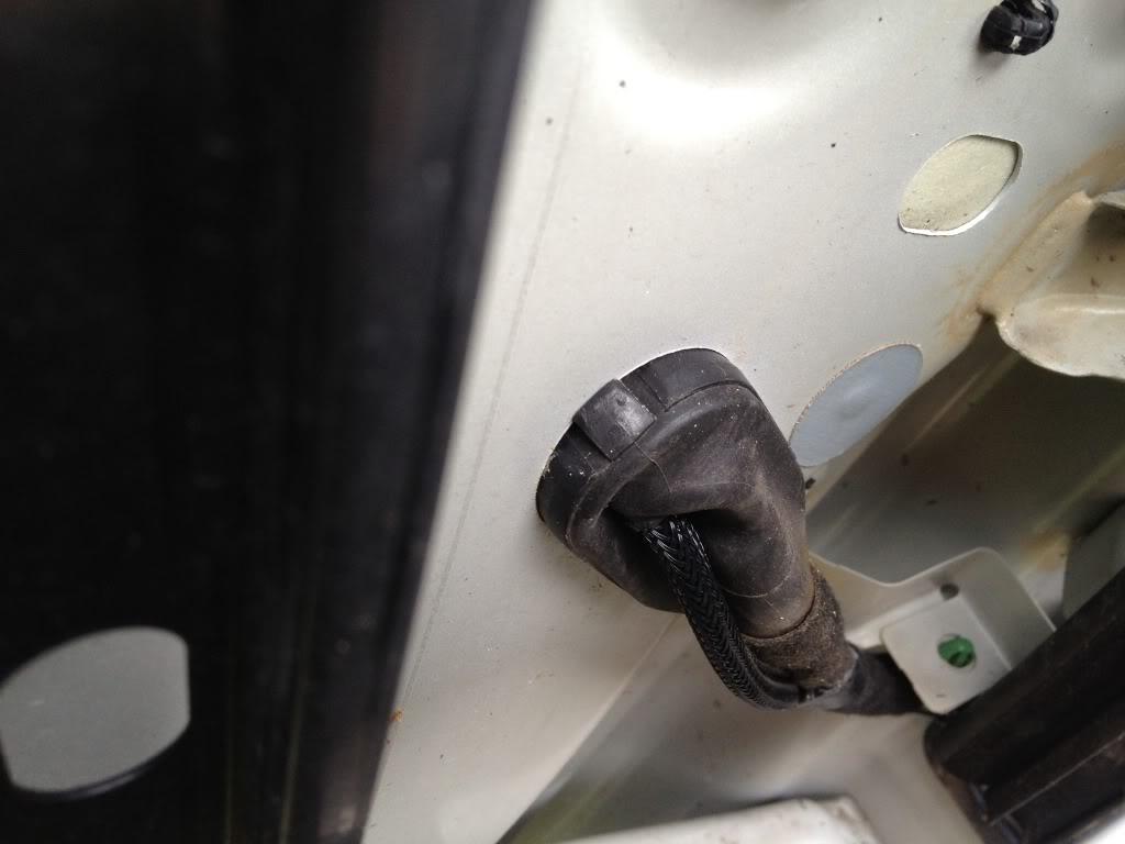

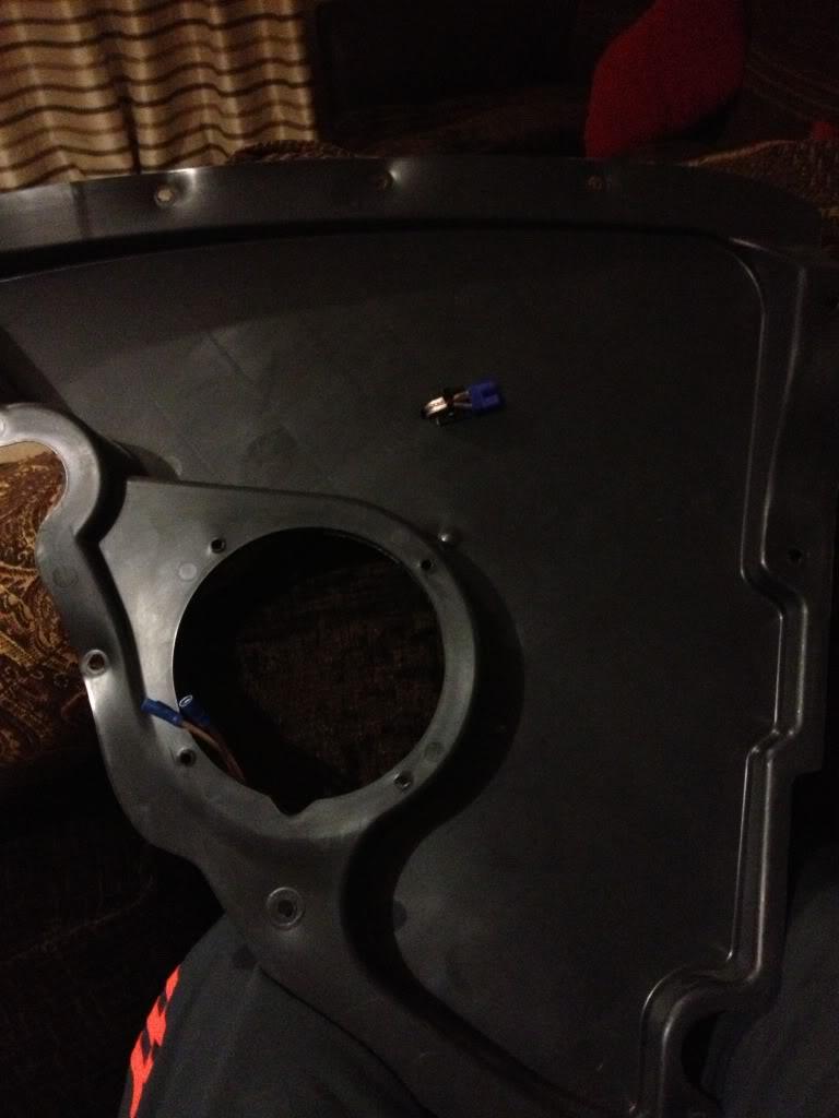

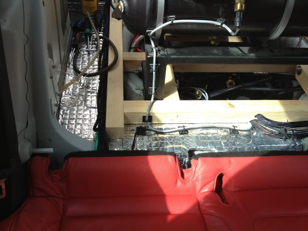

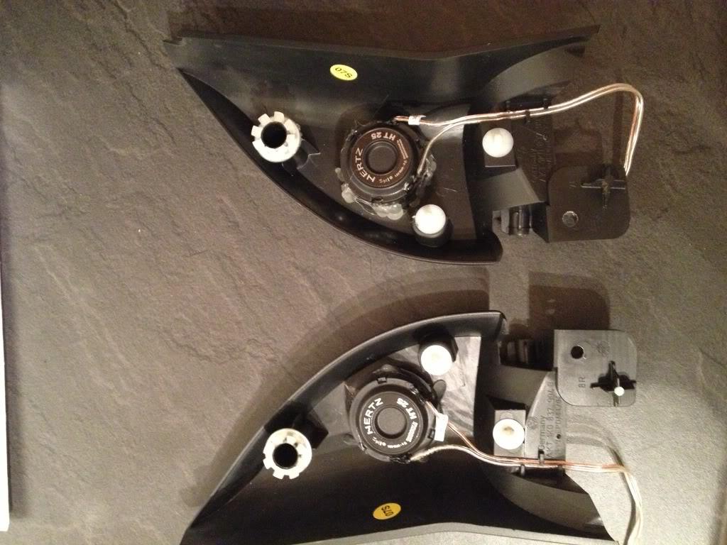

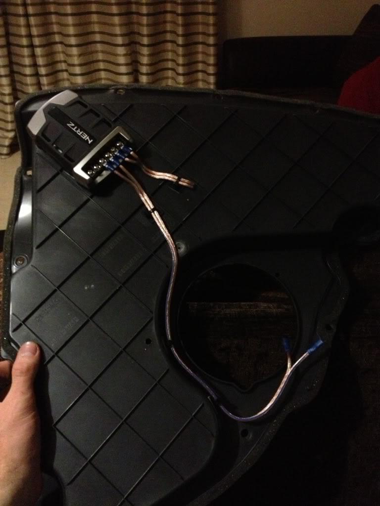

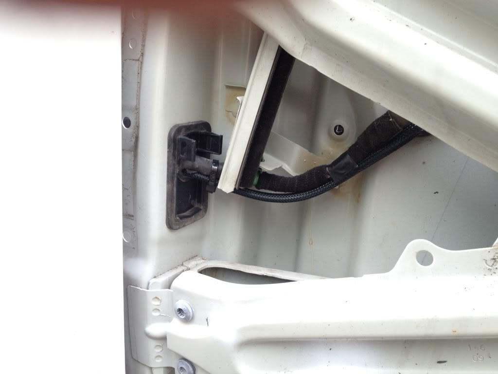

Here's a load of pics. I'm Too tired to organise them so I'll just throw em up in whatever order photobucket decides lol

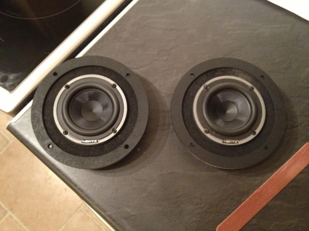

« Reply #26 on: July 09, 2013, 10:34:57 pm »
Did you rivet or screw the adapters in place? Any idea of the rivet size if you used them?? Cheers

« Reply #28 on: July 10, 2013, 09:47:19 am »
I screwed and bonded the adaptors in just in case i was to change to wooden baffles in the future i wouldn't have to take the door skin off to do it. Shoulda gave me a shout Rob :)

« Reply #29 on: July 25, 2013, 08:48:33 pm »
How did you get the power cable to the battery? Iv started stripping it tonight...
