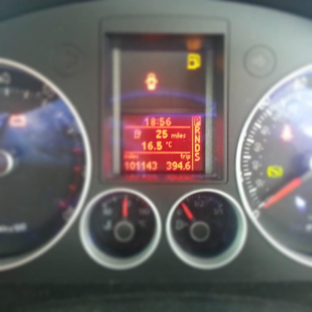

From my recent 1040 miles trip  :driver: :happy2:
2.5 tanks for the whole trip
