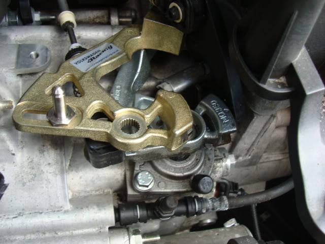

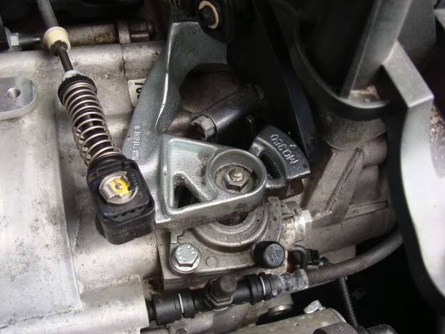

a couple of pics from rocco which has same issue as some Ed30s and our Pirelli

im missing it... so the bit that sticks out hits that other bit?

the shape of the bit with M0.. is a different profile to the equivalent bit on the short shifter, the profile of the short shifter is what have been casuing issues, vwr are fabricating new onesto overcome this issue
