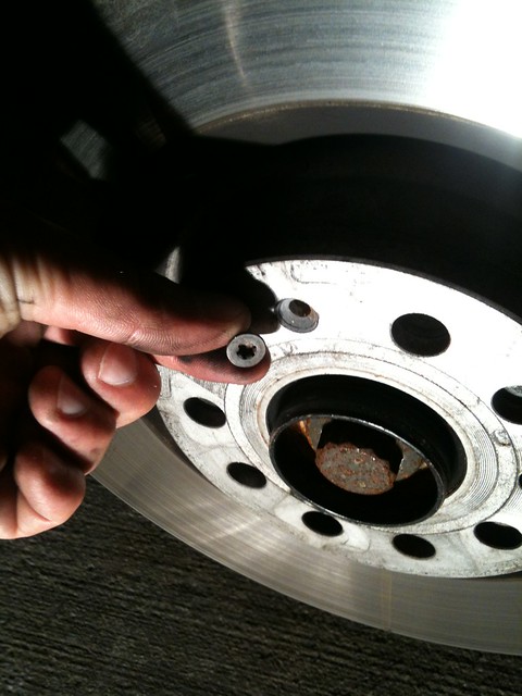

Benz rotors have a different inside hub diameter than VW rotors. The Benz hub diameter is 67mm. The VW hub diameter is 65mm. You need to run a spacer to fill that gap. If you do not run the spacer you will get wobbles at certain speeds that feel similar to your wheels/tires being out of balance. Almost all cars these days are hub-centric so the rotor needs to sit securely on the hub, the lugs will not accomplish this task sufficiently you have to run the spacers. These spacers are available in plastic and metal. I would only run metal because brakes get very hot and could potentially melt the plastic. I bought a pair of aluminum spacers from John for $10 which was a great deal. The cheapest I found them online was $20. The ones he sent me fit however they stuck out farther than the hat of the rotor so I had to grind them down flush with the face of the rotor hat. I did not take a picture of these and I apologize. If you snap the spacer into the Benz rotor you will see what I mean. Mark the excess with a sharpie, grab it with two pairs of pliers and grind it off with a bench grinder. Its aluminum and aluminum is soft, be careful.
Stock rotor "set screw" hole

The only sensible engineering solution to the centering ring issue is to take the centre bore of the disc OUT to 68mm and then create a centreing ring that is 1.5mm wide instead of 1mm. Dont forget the ring is only that thickness at the top as it has to taper to cover the Rad a the bottom of the spigot.
whilst the disc is clocked up we give it a new countersunk mounting hole to match the VAG hub. The end result is somethig which is in essence OEM.
Got to love the forums where theyre telling you to grind stuff away to get it to fit.....
