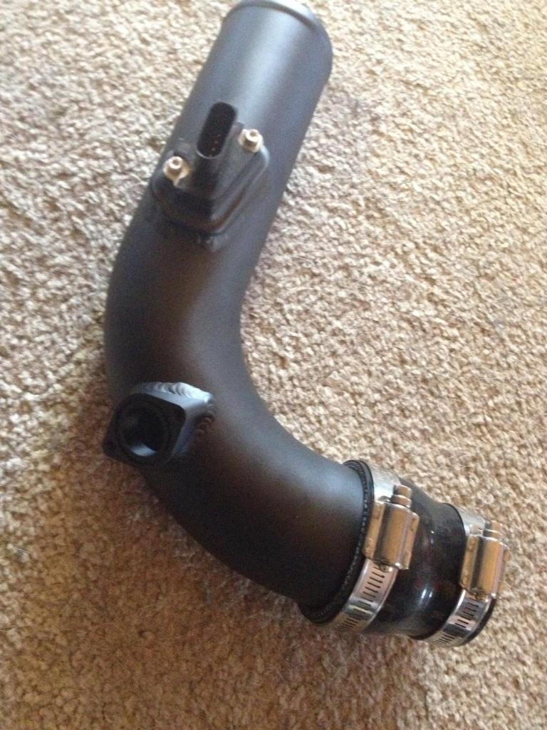

Apologies if this is listed elsewhere but I didn't see it and I'm pretty sure I got the wrong part from Forge. It has 2 bungs on the hard pipe coming off the turbo inlet, one for the MAF of course, the other is circular and I have nothing that would go there. Here's a pic:

you running a normal GTI K03?
Think that pipe is for the ED30 K04 turbo, just need a bung for it (block it in)

Yup, that is now the correct piece for both k03 and k04 turbo cars. Just contact Forge to get the correct bung to block off that port.
