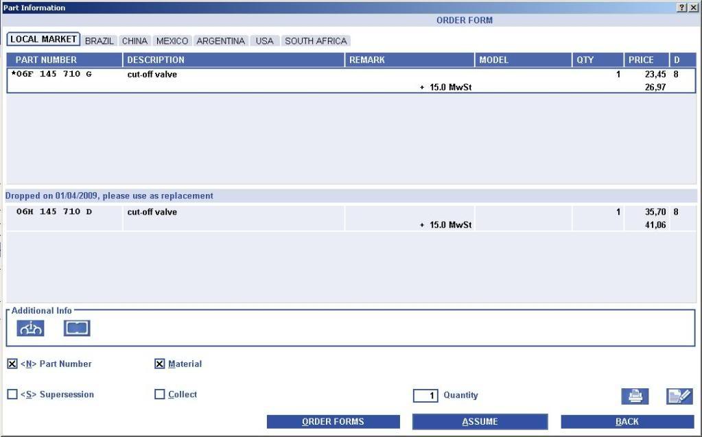

Don't think you can buy the D valve anymore from the dealers, I have a G fitted to mine because i was told the D had been superseded
Just checked my version of ETKA (which is reasonably up to date, Update 766) and it says the G version was dropped on 01/04/09. the replacement is the revision D cut off valve (as it's called in the parts system.)
So the right part number to ask for is 06H 145 710 D  :happy2:

« Reply #21 on: August 28, 2009, 08:05:38 pm »
so are you saying that all FSI cars will now be using the new TSI D valve if you want to replace it ?
Red ED35 5dr DSG
BLOG | BUILD
Offline SteveP
  • -Given: 117
  • -Receive: 341
  • Posts: 6005
    • My Project
Re: DV update
« Reply #22 on: August 28, 2009, 08:11:29 pm »
^^^ That's what ETKA suggests to me, plus mojo listed parts we was having replaced under warranty in his power loss thread and it was the latest revision D cut off valve too  :happy2:

I don't really have the software this is a screenshot a friend sent me  :wink: :laugh: :laugh:
