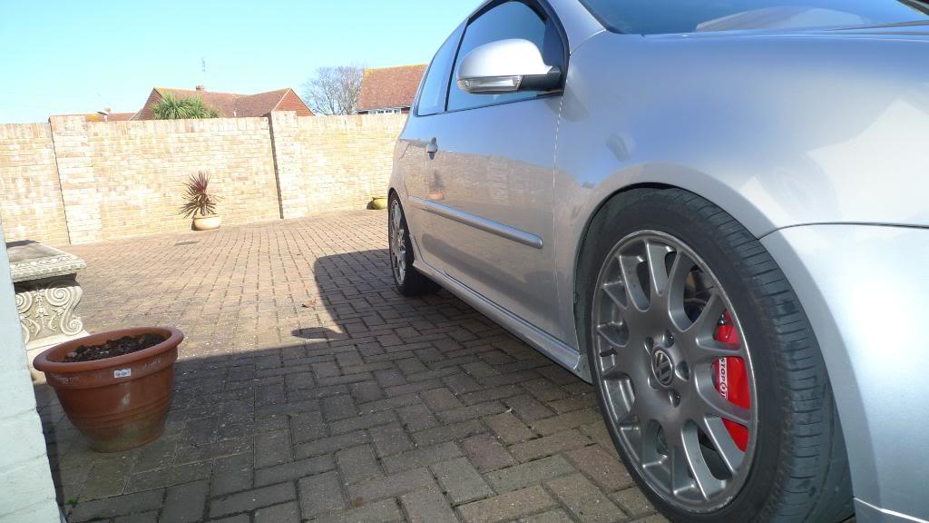

paid a bit less than that for my B16 pss10's, and that is saying pss9. the 10's are the latest to be released and have one extra adjustment setting, the B14's are non adjustable.
good review and install pics here  http://www.golfmkv.com/forums/showthread.php?t=24492
with 1 been the softest setting and 10 the hardest, i have mine set at 5 all round and the ride is a little harsh on bumpy roads but a soon as you get on a nice stretch it is very smooth and responsive, you can throw it around and it just grips and roll is minimal thats without ARB's, just got it low with 10mm spacers all round, with bsh rear arb soon to come..

where did you buy them from if you dont mind me asking. your ride height is about the height id be going for, dont want to go to low.
I was mainly interested in the B14 coilovers as they had been fine tuned on the nurburgring, which is basically a really bumpy and undulating 1 way b road. so i thought they would be awesome for the road.
however since i plan on keeping this car and eventually stripping out the interior and using it predominately on track and as a weekend toy, The B16 pss10 might be worth investing in. plus they look mega easy to adjust the damping.
Where are the adjustment knobs on the KW coilovers. are they in similar positions?
