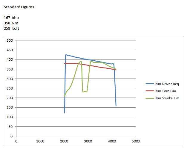

Ok, my first attempt at logging any data using VCDS (Engine - Block 011).
I've been having a slight issue with my turbo/boost every now and then. I wanted to try and replicate it and also to see if my car is remapped.
So I logged the boost (not shown here yet) and the Torque (Nm) which is split into Driver Requested(Blue line) Actual limit (Green Line) and Smoke limit (Red Line)
Can anybody tell me if they have heard of/experienced this hesitation of the BMN engine/turbo before.
From the graph/numbers I peaked at 428 Nm of Torque so I guess the car is remapped after all (I bought it not knowing it was mapped).
I'll post this in the VCDS region of the forum when I have time tonight. Thanks for any help/insight.

I don't think I can help with your hesitation issue but just for info, the 170 is the BMN engine which also uses a different turbo to the BKD  :happy2:
Arrgh, typo error. I'm so used to typing about my previous Golf. I do have the BMN engine. Thanks Matt. What's your power/torque figures? I was only seeing 1.6 BAR max of boost being requested. Quite low for a diesel (that's probably mapped).

I have mine dyno'd a couple of weeks ago. Ran 200bhp/447Nm. I did find that it is over fuelling a fair bit though which is why I get lots of smoke. Going to get it looked at soon.
Also due to the limitations of VCDS you could be running more than 1.6Bar but it won't show that it is.

From the graph/numbers above I peaked at 428 Nm of Torque so I guess the car is remapped after all (I bought it not knowing it was mapped).
Easy to see if a car is remapped. Go to Engine 01 > Advanced Measurements > Et Voila (above)
