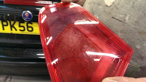

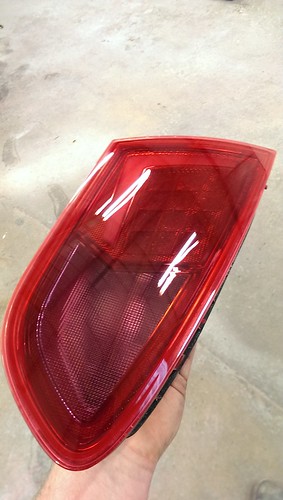

some of my back lights arrived today,
one is a used one for the bargin price of £20
the other three brand new, slight hitch though as one was the old non led version
when the lights turned up i knew why the light was £20 :(
heres the starting point
IMAG0556 by cuprajake1, on Flickr

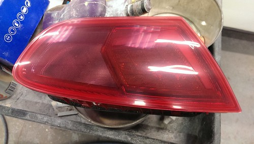

used 3m 1500 grit on machine, followed by a 6000 trizact pad on machine to give this
IMAG0557 by cuprajake1, on Flickr
then machine polished up with 3m fastcut plus and then 3m fine polish on waffle pad
giving me this
IMAG0561 by cuprajake1, on Flickr
good as new again, ill get the last light tomorrow and fit it, the led illuminate but go stright out !! so need coding in next
jake

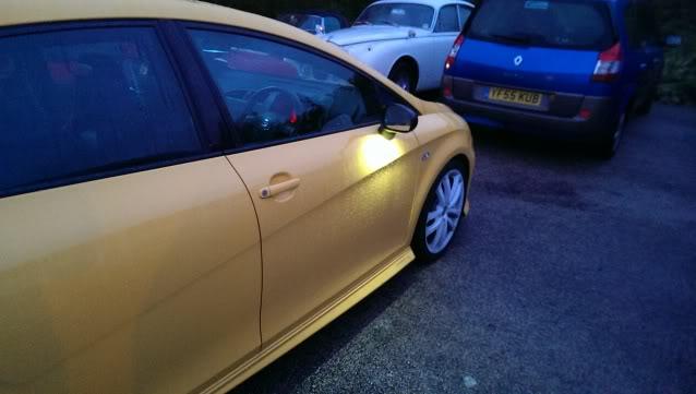

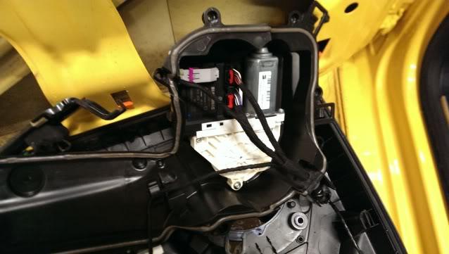

« Reply #134 on: November 11, 2013, 07:43:32 pm »

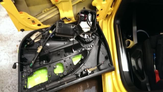

Decided to fit puddle lights to my mirrors.
No mean feet.
Basically the door cards are a complete pain in the arse. The full window mech is fitted to the back of the card, so before I started I checked that I could code the module with vagcom. The checks were good so I stripped the doors down and ran wires then added the pin and coded the lights.
Pics are poo but you get the idea. The lights come on upon unlocking and stay on longer than the coming hone lights. They also active when the doors are opened.
