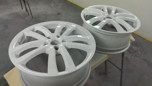

Next job was to sort tbs winter wheels out for the tyres which came today.
I thought to myself, with winter being so mucky what colour can I get away with not cleaning n just leaving for a while. I'm sure you'll agree this is perfect for hiding the dirt.

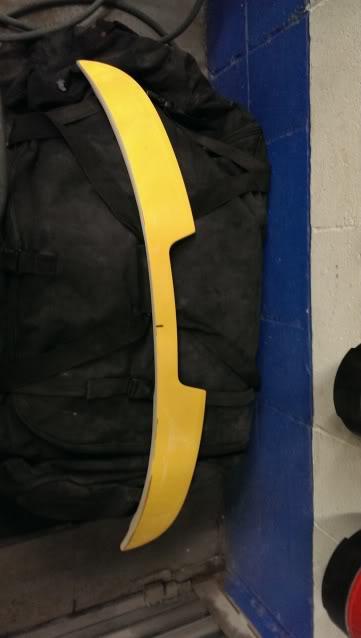

Today I realised a btcc spoiler, no matter how much you trim it won't fit a face lift tailgate, so expensive test but it would of been unique,
So quick call to seat and ordered a propper one
So after work I stuck the tailgate into the booth for colour
Also painted one of my mirror caps as that was scuffed
I've ordered a new high level brake light as there different, I bagged two rear lights off ebay for £40 as well, then for new yr I'm going led,
I'm thinking gloss black for the spoiler and maybe a dewiper on the hatch, but that's only if my motor doesn't fit lol

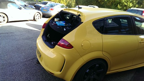

managed to get the tailgate 90% fitted today,
for anyone wanting to do it, some bits are different
firstly the wiring loom works all the parts on the fl tailgate, how ever the upper brake light wire needs extending as they changed the location of the plug, speaking of the light that has to be new too and there £30
next the mount for the gas strut is different aswell it must be shorter, so i need to order that.
i currently dont know if the rear panel fits either lol,
im kinda stuck now till i get bits, so final adjustment will be done when they all arrive, the o/s isnt flush yet but the n/s is
here are some pics:
