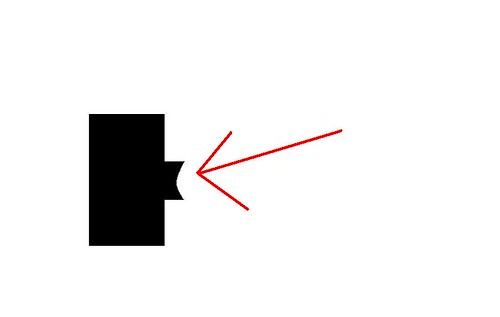

fitted the joms today with the help of chris.
i wound them leaving about an inch of thread and tbh the car looks like standard ride height. i still need to adjust everything but surely that cant be right. i know they should settle but about 2" lol

Figured it out,
me lol wrong instilation, ive never done a mk5 chassis, only mk4 now on a mk4 the tab locates the bolt, obs not on the mk5
this tab\/
STRUT by cuprajake1, on Flickr
goes below the bolt, thing is i rand dpm and h said grind the middle
Tornado red ed30 #0728

 :scared:grinding new coilies... Not My cuppa tea ? I'm guessing grinding to allow them to wind lower?

Had to do the same to mine, Think its all to do with the 55mm colar, as on 50mm hubs the fit fine. Bit of a poor design but nothing that effects there operation.
