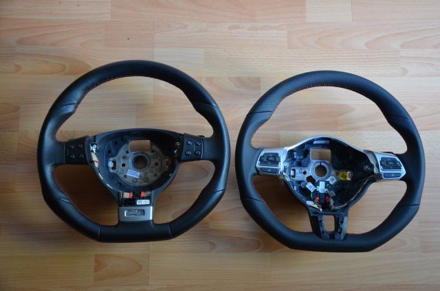

So guys i need a bit of help.
I just bought mk6 gti dsg , mfsw steering wheel. Aslo bought CH module. mk6 to mk5 system.
But i have problems with airbag. I was at dealer that sells airbags. We tryed 2 different models and no one fits.( it fits in but it stays still, no room for horn ) Where could be the problem.
How many different airbags are out there for mk6  wheel...

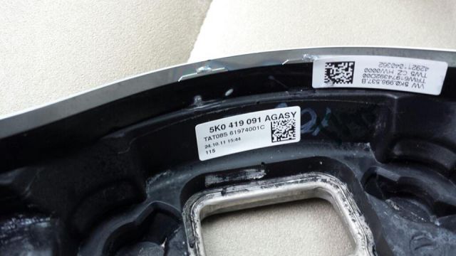

This is part nubmer from my wheel:
any part numbers for airbag that could fit?

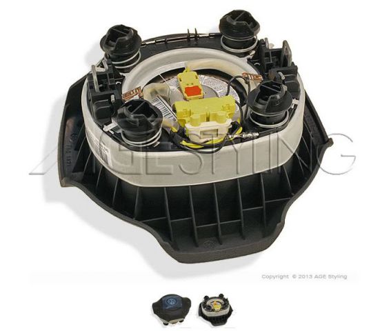

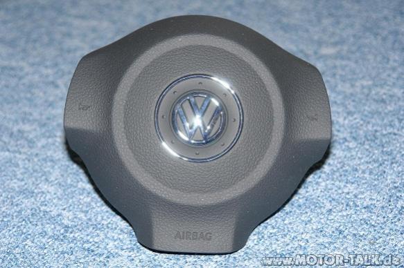

it has to be this shape:
is it possible that is difference in these black or white four plugs ??

Could well be those fixings  - does your wheel have phone button?

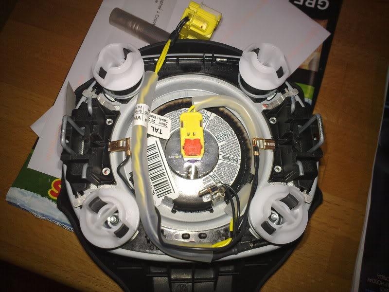

there it is . on the right
phone button is there

demon666, i don't think that's the right shape , that i am looking for....
I tried 2 airbags yesterday, they didn't had any part number on it. But is it possible that is right shape, but that doesn't fit...if u push it in, the back 2 ''locks'' moved. And if u want to push the horn , the air bag doesn't move.

you must use the multifunction version
if you don't it will be difficult to get the horn to work
