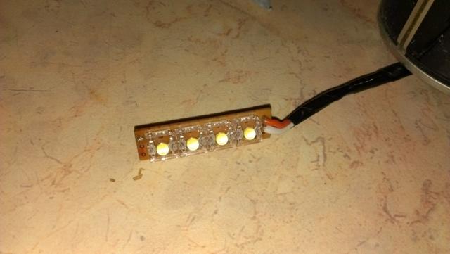

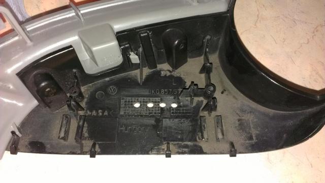

Electrically they are easy to install. Most door controllers have outputs for them. They just need to be wired to the correct pin and coded in. :happy2:
Mechanically though is a whole different kettle of fish. The folding mirrors are a slightly different shape to accommodate the light and the motor. These are designed as a direct replacement for the OEM bulb unit.
I went for a row of 4 bright LED's in each mirror and wired them into the door controllers:
Apparently I didn't get round to putting the pictures of it completed on photobucket, must try harder!  :sad1:

That looks like a pretty good how-to but you have to be pretty patient and good with a dremel. Yes I did code them in myself.
Be careful though, the ebay listing units that you stated in your original post are different to the ones in the how-to. The ebay ones are a direct replacement for the OEM ones.
They fit to the mount opposed to the bottom of the mirror:
