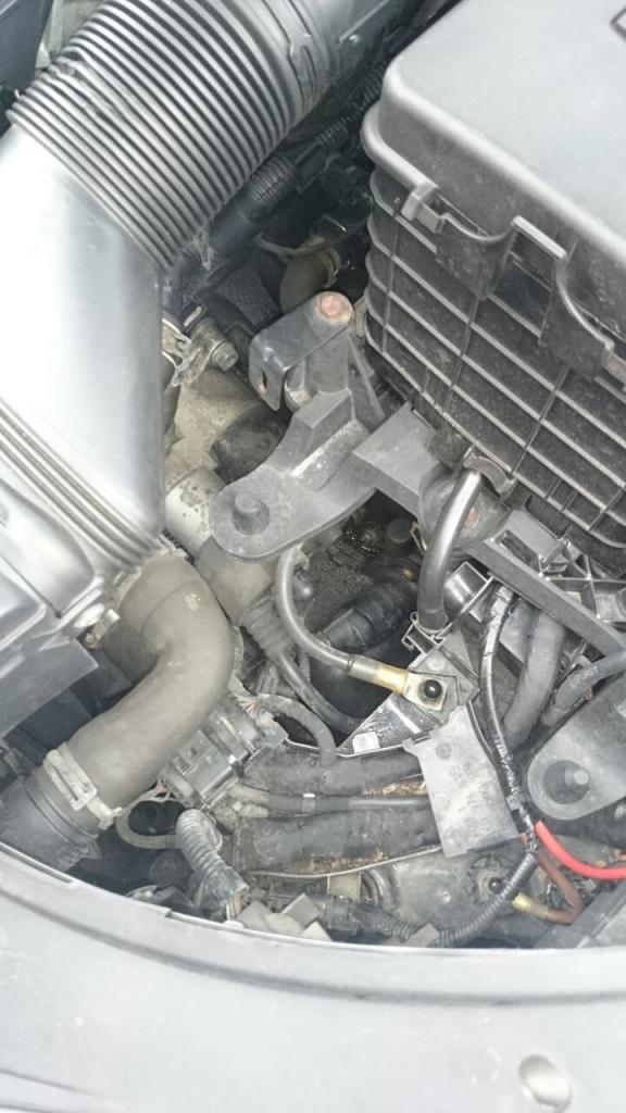

Here is photo where the leak is. I want to get this leak sorted oviously before i change the oil
The oil is over the top of the gearbox. around the where the springs are in the picture and half way up the cover part
Any Ideas?

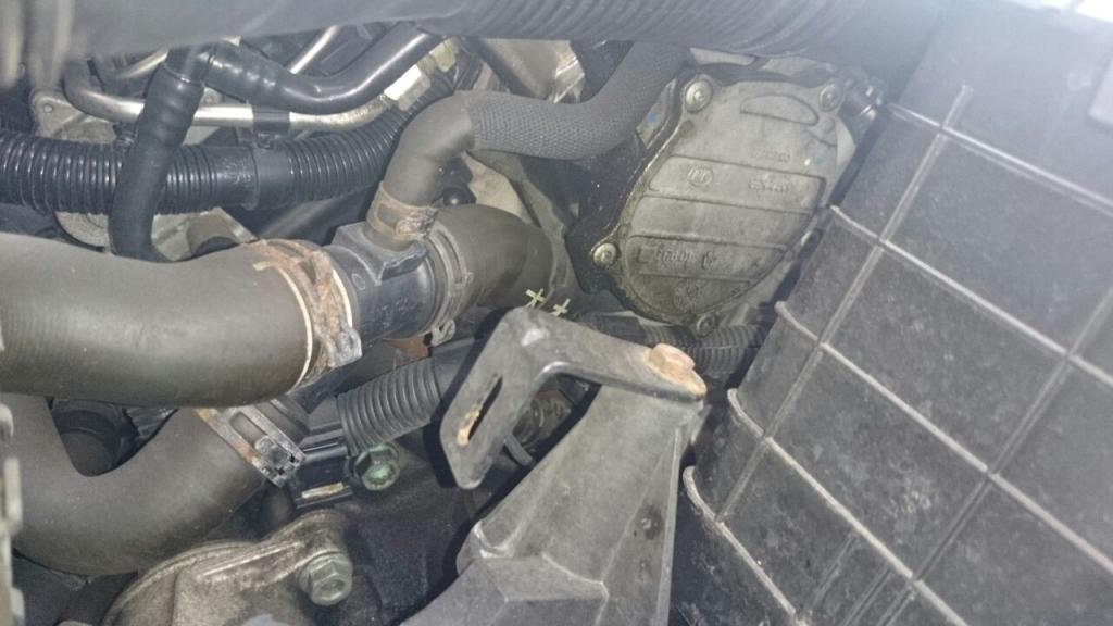

Wow..i just got back from viewing a potential GTI to be bought..07reg exactly has the same spot of oil leak..i also think it is the vac pump..any idea how much??
Edit: anyone had experience changing the part?

« Reply #12 on: September 04, 2014, 09:15:20 pm »

Bump...i have this...oil seems to be seaping from this cover...is it just the large oring or is thrre a gasket too
