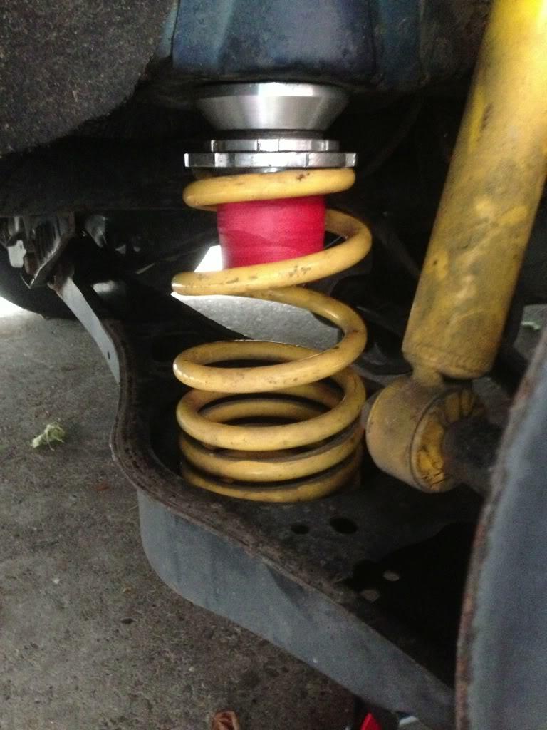

The smaller diameter end is at the bottom and doesn't sit properly on the strut.
Shouldn't the small diameter coil be at the top? If so, I wonder how the large diameter coil is retained by the smaller plate at the top!
Should I be worried or am I wrong?

Should look like this
Minus electrical tape...

« Reply #6 on: October 18, 2013, 09:43:40 am »
Problem solved!
The springs were twisted round 180 degrees so the bottom wasn't seating correctly. This caused the spring to tilt and look wrong.
I lifted the car to ease pressure on the springs and found I could turn them by hand to their correct position in the bottom plate.
Hopefully they will now stay there!
