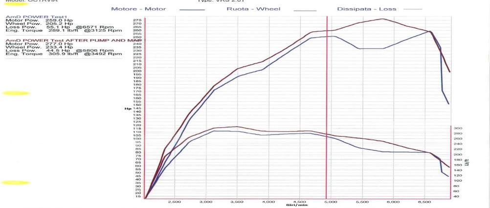

mine is only a GTI 200ps engine, not ed 30 spec. So those figures are way above what i would get.
had the dyno session done. need to upload the dyno sheet still but it managed 259bhp 289Ibft at stage 2 with an issue at high revs, at stage 2+ it managed 277bhp 305Ibft and the issue is sorted out.
Ill upload the dyno sheet asap

Those figures seem pretty good, but that's dependant on the dyno/operator etc...

yeah im happy with the results the car feels alot more eager to pull, and is consistantly more powerful and torquey along the whole rev range.
the dyno was done with only a five minute drive for the new bluefin map to adapt, so it should eventually flatten out some more

VRSY, on your RR graph the "before" run shows a massive drop in power around the 5500rpm range....do you know what caused that?
i have just put on stage 2+ map (or what im assuming to be 2+) and in 3rd and 4th at 5500ish the power just dies then picks back up.
