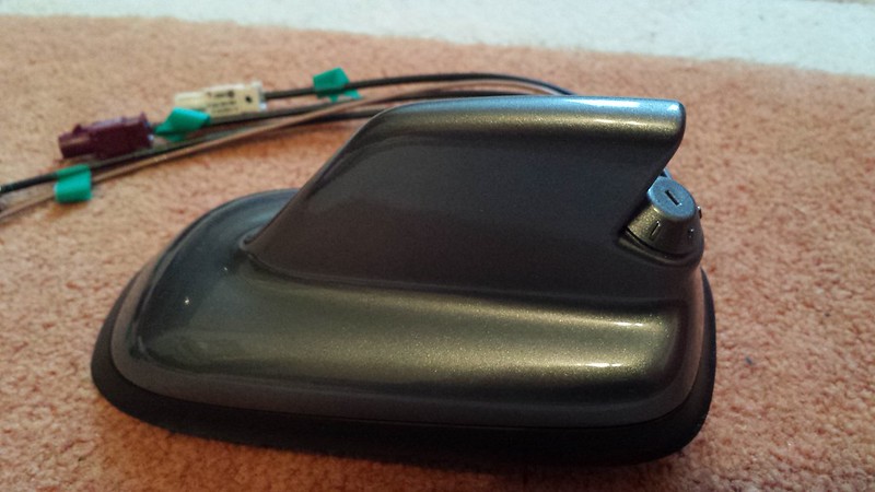

« Reply #10 on: November 23, 2013, 03:38:48 pm »
Here it is, got it professionally painted, looks great, can't wait to get it fitted.
http://www.flickr.com/photos/49118648@N02/11011223633/
Will fit next week and post photos.

Looks good painted but what did you do about the mast?
Remember:-
When fitting a 22mm short reach spanner is the job and the white plug is taped to the roof and a read of this May help
http://www.golfmkv.com/forums/showthread.php?t=3508

« Reply #13 on: November 24, 2013, 09:02:20 pm »
Cheers, that link will be very useful.
The mast is still in its wrapper, it looks pretty stubby and smooth. The base comes with a bung protecting the thread, left it in for the paint. I did wonder about the contrasting black mast but in fact it looks really smart. Looking forward to seeing it on the car.
