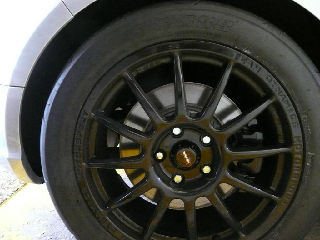

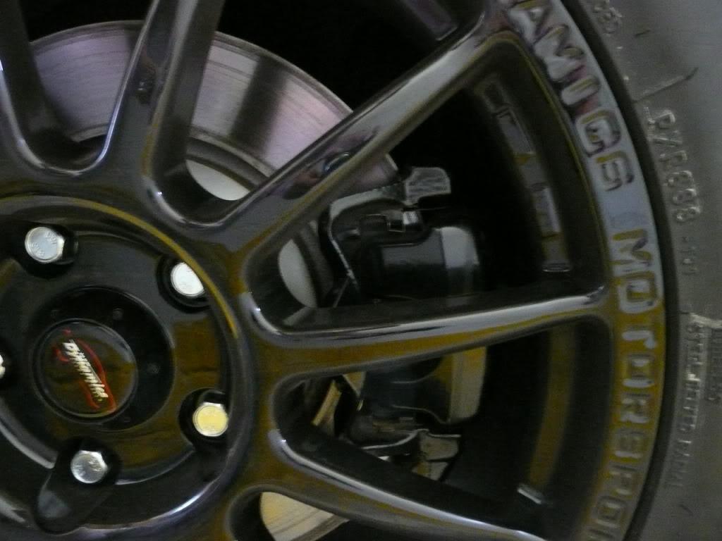

Upgraded the rear brakes this afternoon. Managed to get hold of some S3 rears - not painted yet and quite like the look of the black with the wheels anyway at this point.
Fitted straight on, but unfortunately the S3 disc guards wouldn't fit, so I've ordered some Cupra ones that will.
First opinion is that the rear is a lot more stable under hard braking. The extra grip of the R888's along with the braking power of the TAROX 10 pots meant that the rear became under braked power-wise and was trying to overtake the front-end/squirm wide on hard use. Now the rears seem a much better balanced. :jumpmove:
Pics not great, but you get the idea. :smiley:

Watched on as Craig at Stattlers slotted them on for me!
They don't need ANY adapting at all. :smiley:

Good news.  The Ed30 guards fit with a little bit of tweaking (bending them slightly out of the way, as in my thread.........
http://www.mk5golfgti.co.uk/forum/index.php?topic=2113.0
Glad someone else has verified that the rear feels more stable with S3 rear brakes fitted.
