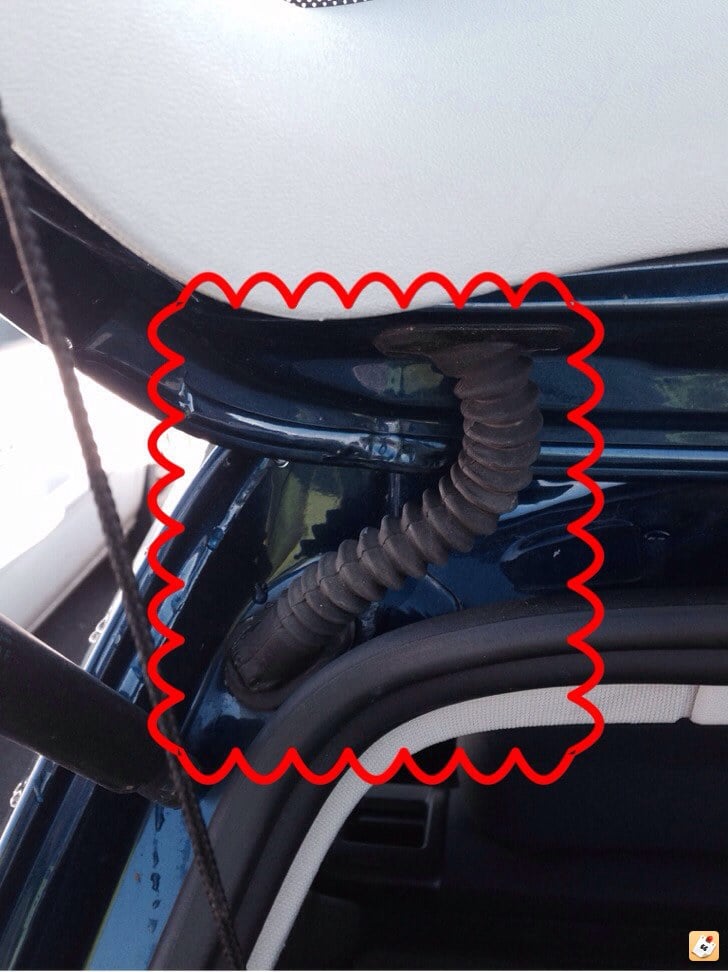

So having a quick look at the boot.
I take it I remove it from these locations.
Remove these
Then pop this off?
But the wires shown below
Is this best to remove from the boot panel or inside the car? One of both sides.
I haven't had my new tailgate yet, perhaps it mall makes sense once I see what I'm working with. Just forward planning.

« Reply #5 on: December 01, 2013, 12:00:05 pm »
Just look at the tailgate wiring part on this thread and you'll see what's what
http://www.mk5golfgti.co.uk/forum/index.php/topic,10027.0.html
Disconnect at the C panel and the fixings you've indicated - (bit of help so you don't drop it on removal and refitting) and it's pretty straight forward as Scottymon stated! :happy2:
