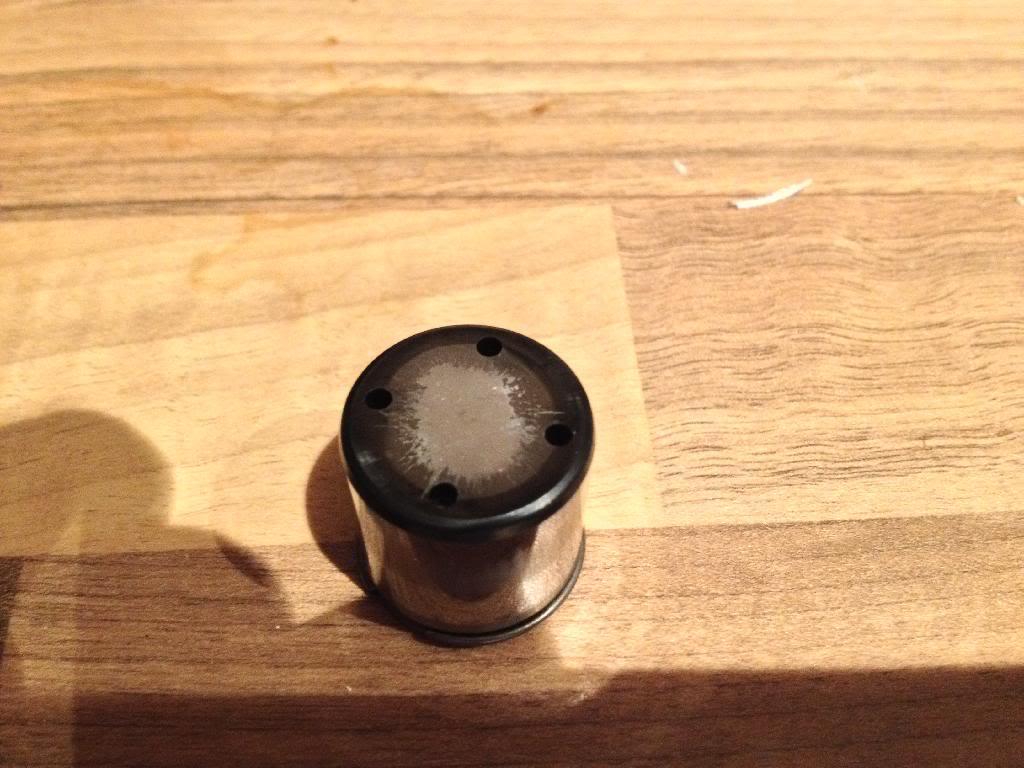

« Reply #11 on: December 07, 2013, 05:39:28 pm »
Hi gang
I've just changed my cam follower tonight and I have banjo bolt but pressure relief valve too.
It took about 40 mins and I found it an ok job. I did break to retaining clasp off the left hand cable connector on the pump so I had to bodge it in place with a self tapper for now  :scared:  I will order a new one.
See pics below for wear, Im presuming its the original on a 55 plate with 66k, blufin stage 1. Not too bad, but the hardened coating has worn so I'm presuming I changed it at the right time?!
Bodgetastic!!! :ashamed:

Yeah that connector is a pain in the arse! I struggled with that too and could do with a new one.
Mine was like this car had 89k and is standard. Not one done in the history so presume it is the first change.........
Offline samb377
  • Posts: 34
Re: Cam Follower Replacement - Pressure Release Banjo Bolt
« Reply #13 on: December 07, 2013, 10:16:11 pm »
That's significant wear. It's a good job you changed this when you did... once the hardened layer is worn through I'm guessing it doesn't take long to fail (there's a reason it there). I'm at the stage now when I check it every year and replace as necessary. Crazy that most garages still don't seem to recognise this issue.
