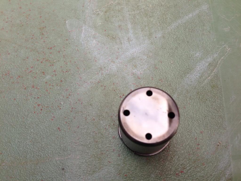

Right I changed my cam follower today and mine is the early two metal pipes. No issues at all pics of the old one bellow. From what I can see in the history it was the original one and as you can see started to show some ware but not as much as I thought.

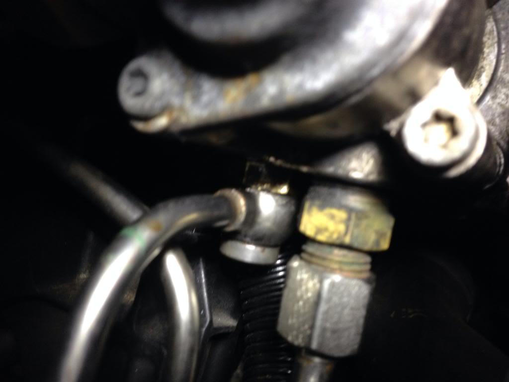

When I did the two fuel lines the right one was no issue as we have all the same and know how to do that. The left one I undid the torx bolt from the bottom of the union. There did not appear to be any washers. Removed the bolt and changed the follower and then used the same one. From looking inside the hpfp there is a thread that it went in to and did not appear to have to cut its own. Little trick was to use a separate torx from another set and then slide a small adjustable spanner over it with some tape on the bottom to stop it falling out this making a small socket set up to allow access.
When you look at it the head of the bolt I removed is the round bit at the bottom underneath the joint on the left pipe. Hope that makes sense. Took half hour.

See pics below for wear, Im presuming its the original on a 55 plate with 66k, blufin stage 1. Not too bad, but the hardened coating has worn so I'm presuming I changed it at the right time?!
Bodgetastic!!! :ashamed:
Looks very scratched. Was to oil ok?
