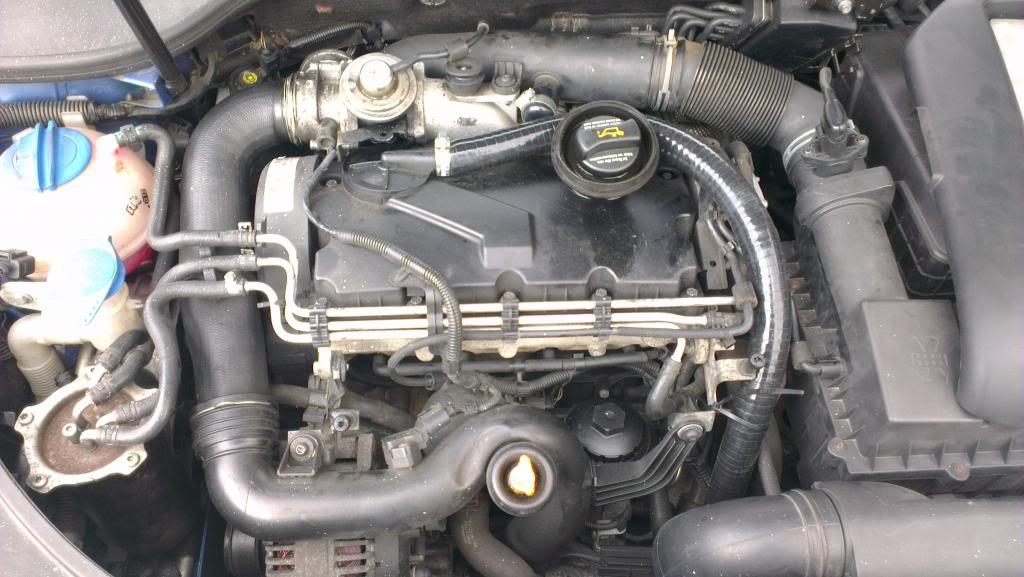

Did the "Elephant nose" mod this morning due to getting small deposits of oil around my boost pipes  so hopefully this and a pair of new seals will sort the problem
i ordered 1"/25mm inner hose size pipe, came to about £12 for the pipe and bung made from proper silicon type hose to try make it look abit neater and oem but you can use anything really as its only to vent of the vapor, some people run a catch can but i havent bothered
