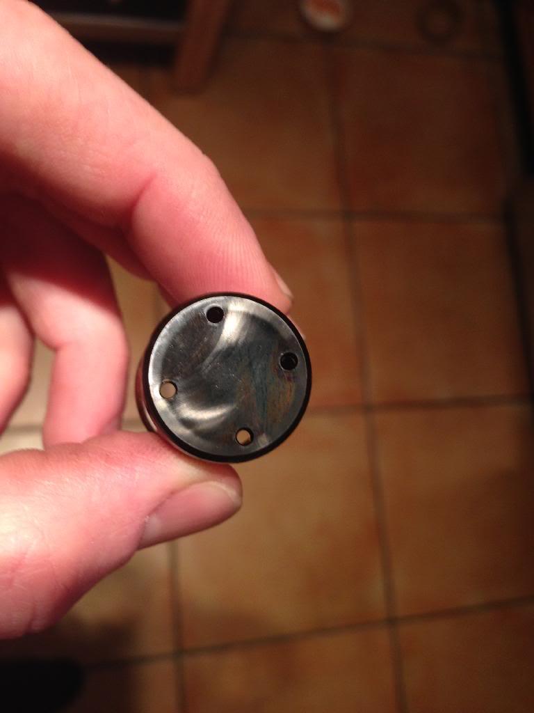

Changed follower today (Yes, did it myself in end! Easy!!)
Thought I'd upload a pic as it was in pretty good knick! I was expecting it to be worse as there's nothing in my history of it being done!?
Changed it out any way along with HPFP seal even though the follower only just starting to wear slightly. (slight halo on coating)

Op. Yours looks knackered. Not many miles left in it before it totally failed.
If the surface of the follower looks concave then the cam that sits on it will be overloaded on the outside edges, check the new one more regularly.

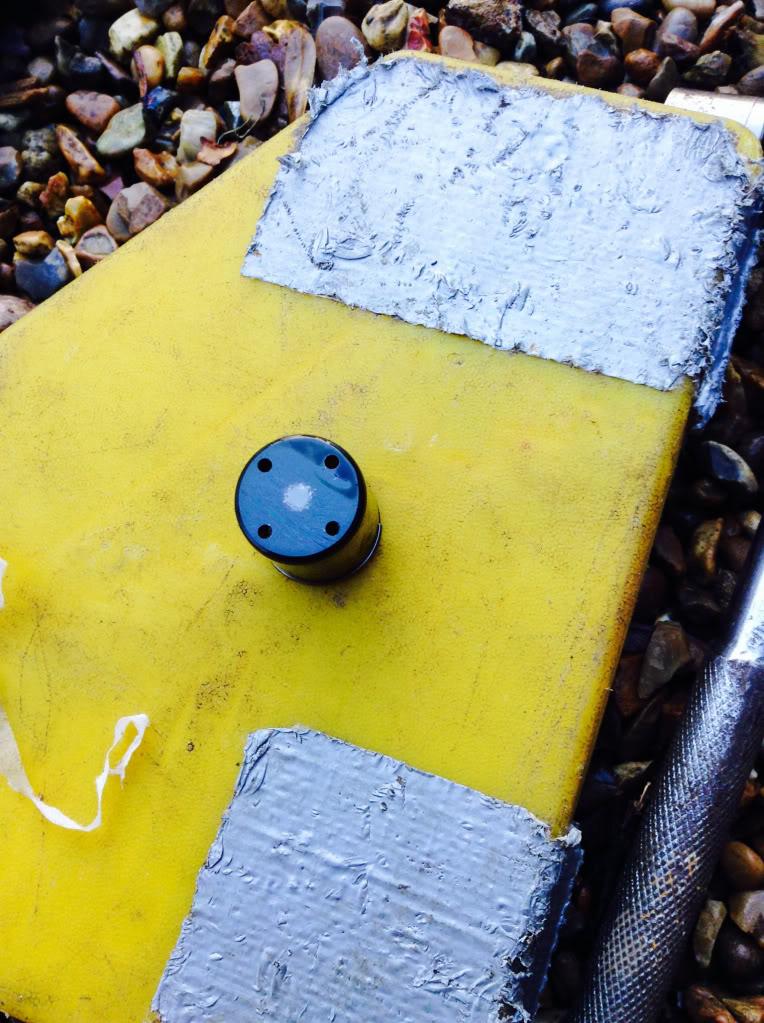

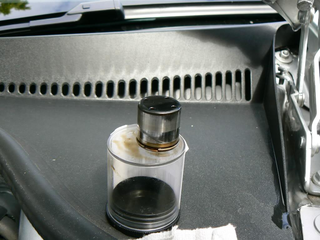

 :grin:
I agree with Shaw on this one  :scared:
Don't think it would have lasted much longer Gman.  :wink:
My first one it changed look like this.....
It had some wear mainly on the inside....
The next 3 cam followers changed have been almost brand new when removed.  :happy2:
