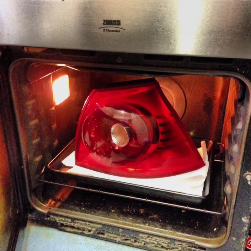

Baking the lights does not help separate them! I did this to try and dry this light out but baking didn't help this either, in the end I used a hair dryer pointed to the back of the light for about half an hour.
