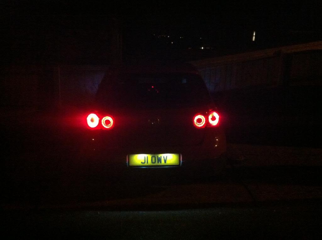

Well gave it a bash and pretty chuffed with the outcome! Still need to have a play with the final wiring and perhaps some led bulbs for the outers. Brightness is good match, just the halogen don't photo so well. Thanks for your guide it was great help and encouragement!!  :drinking:

Looking good!!!  :congrats: The LED bulbs in the outers are really worth doing. I found the outers looked a little orange when compared to the LED rings I used on the inners.
