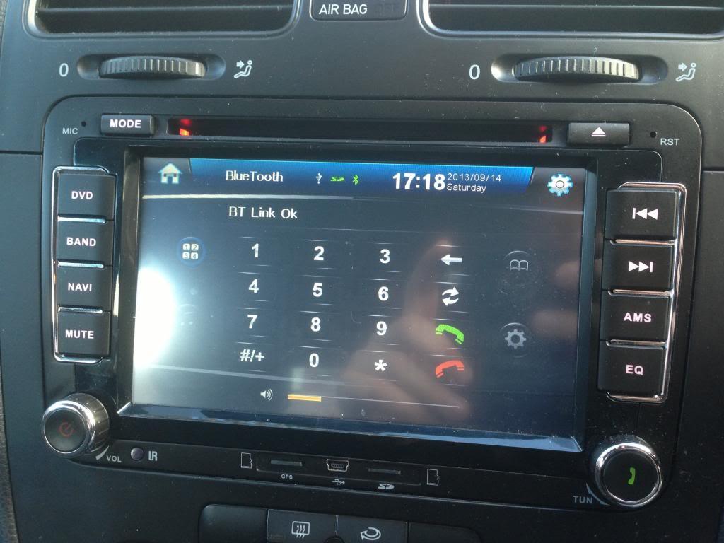

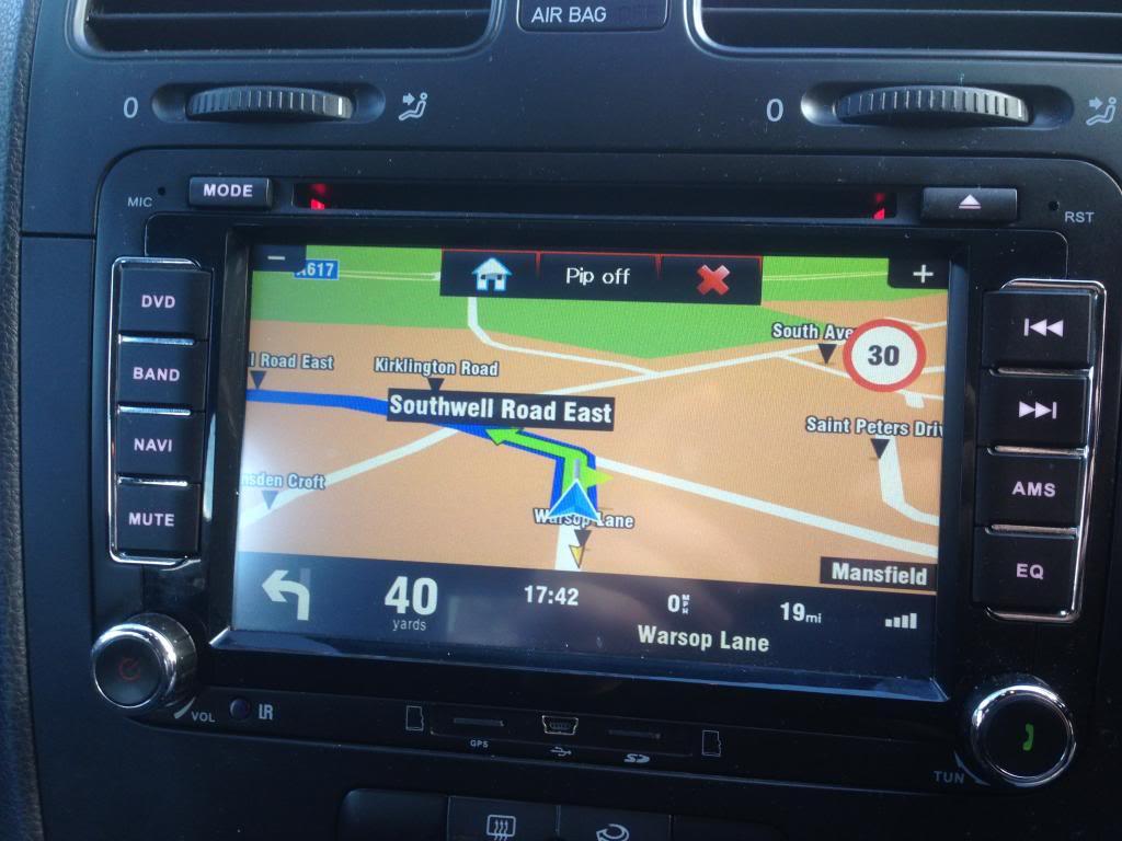

« Reply #19 on: January 07, 2014, 05:33:44 pm »
No battery drain issues at all.  The only thing that you could want to do is wire a switched live to it as you may want to with any after market headunit.  The only reason you'd need to wire this in is so the headunit turns off and on with the ignition.  If you don't wire it in you just need to remember to turn it on and off using the power button on the unit :).
It only takes around 10 mins to wire a switched live to the fuse box though using a fuse tape (http://www.ebay.co.uk/itm/ADD-A-CIRCUIT-FUSE-TAP-PIGGY-BACK-BLADE-FUSE-HOLDER-/321088781277?pt=UK_CarsParts_Vehicles_CarParts_SM&hash=item4ac261fbdd)
You just need to chop the red wire at the back of the headunit connect some wire to that then connect that wire to the fuse tap and plug that into the fusebox.
As I said you do not need to do that though if you're alright turning it off and on with the button.
Anyway here are a few photos for you :)
