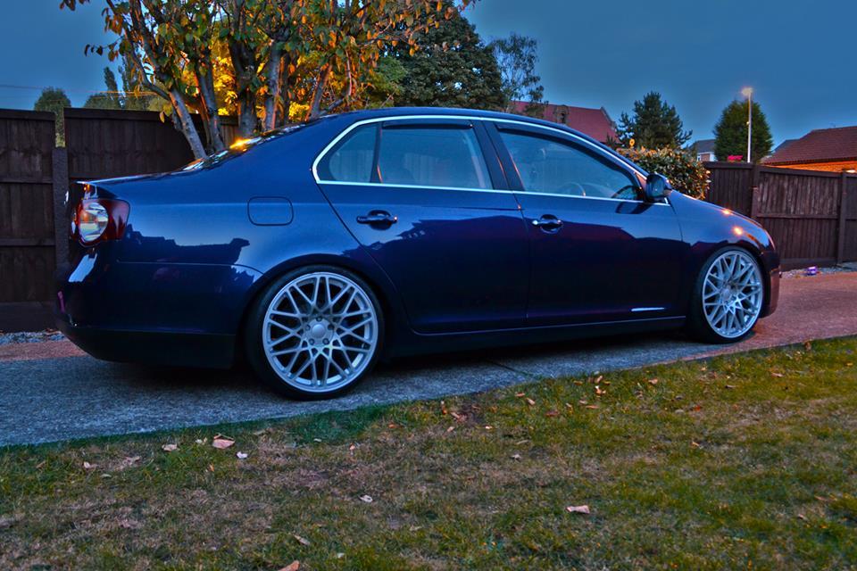

Here are my JOMs (only got a pic of the rear shocks and springs unfortunately) over a year after them being fitted, about 17 months in this picture.
JOMs are very good for the money.
FK AK Streets go lower. JOMs ride better. JOMs also come with a 2 year warranty. FK's only come with 1.
Stainless steel strut bodies are nice to have but the majority of rust is just cosmetic, the most important thing is the threads which if you apply copper grease and tape them up then you'll be fine for years.
