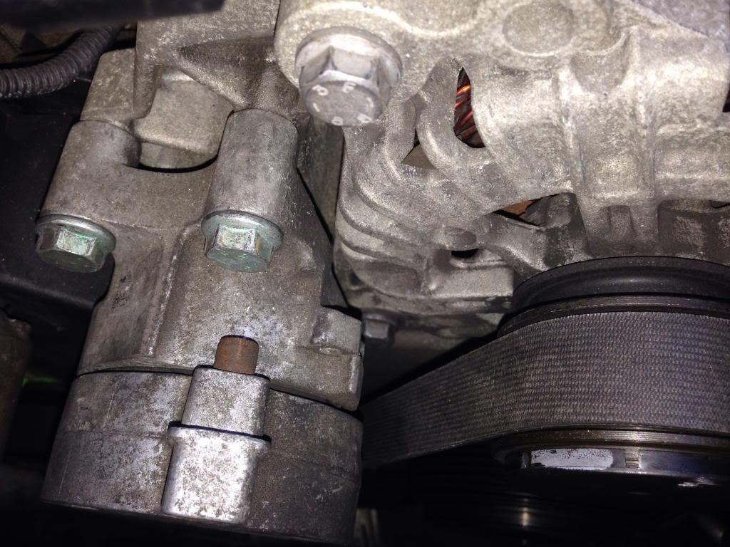

Hello all,
So after deciding to replace my main stat I am failing miserably at the first hurdle!
The guide I have is to release the tensioner 17mm bolt and lock with pin then remove alternator.
Can't see a 17mm bolt they are all 15mm and can't work out how to lock the alternator. Mine is an 54 plate gti.
Pic below of alternator any help much appreciated. Perhaps I should just take it to a garage....

Also retracting the alternator bolts in a strong suggestion, I didn't realise till I had wired it back up than had to struggle doing it in the engine. Used a 18mm deep socket to pull back through from the rear. Photo here if you can make it out :
If you need any advice or tips just ask  :drinking:
