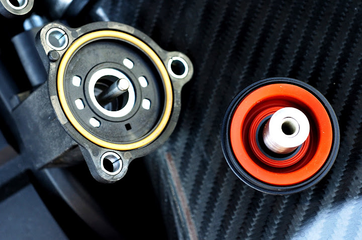

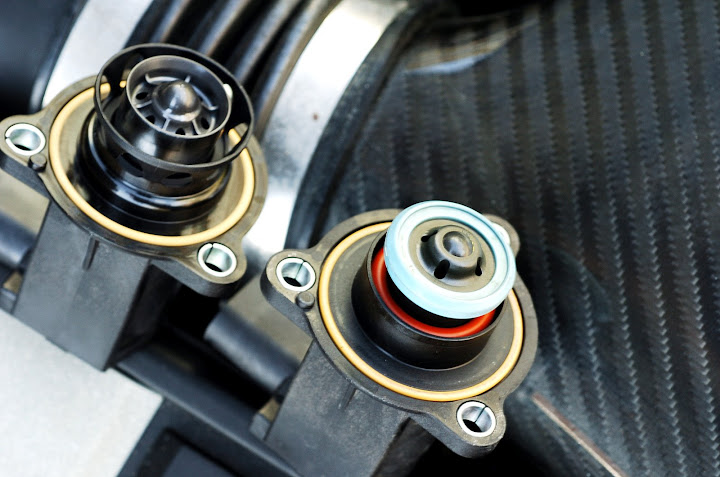

The old style DV is the one with the orange rubber diaphragm. The new revision D is on the left (no rubber diaphragms to split).
Here is a pic of the old style DV opened up.
This one was healthy, but was struggling to hold the boost of the Stage 2+. The revision D valve has a slightly different 'cracking' pressure (in the way that when you pull the valve out by hand there is a manufactured resistance in the revision valve to get it to open against the original unit which is totally smooth piston action - or there was in the one I purchased).
I've been running the rev.D for some time and it's been fine.
« Last Edit: September 27, 2009, 09:34:03 am by warren_cox »
