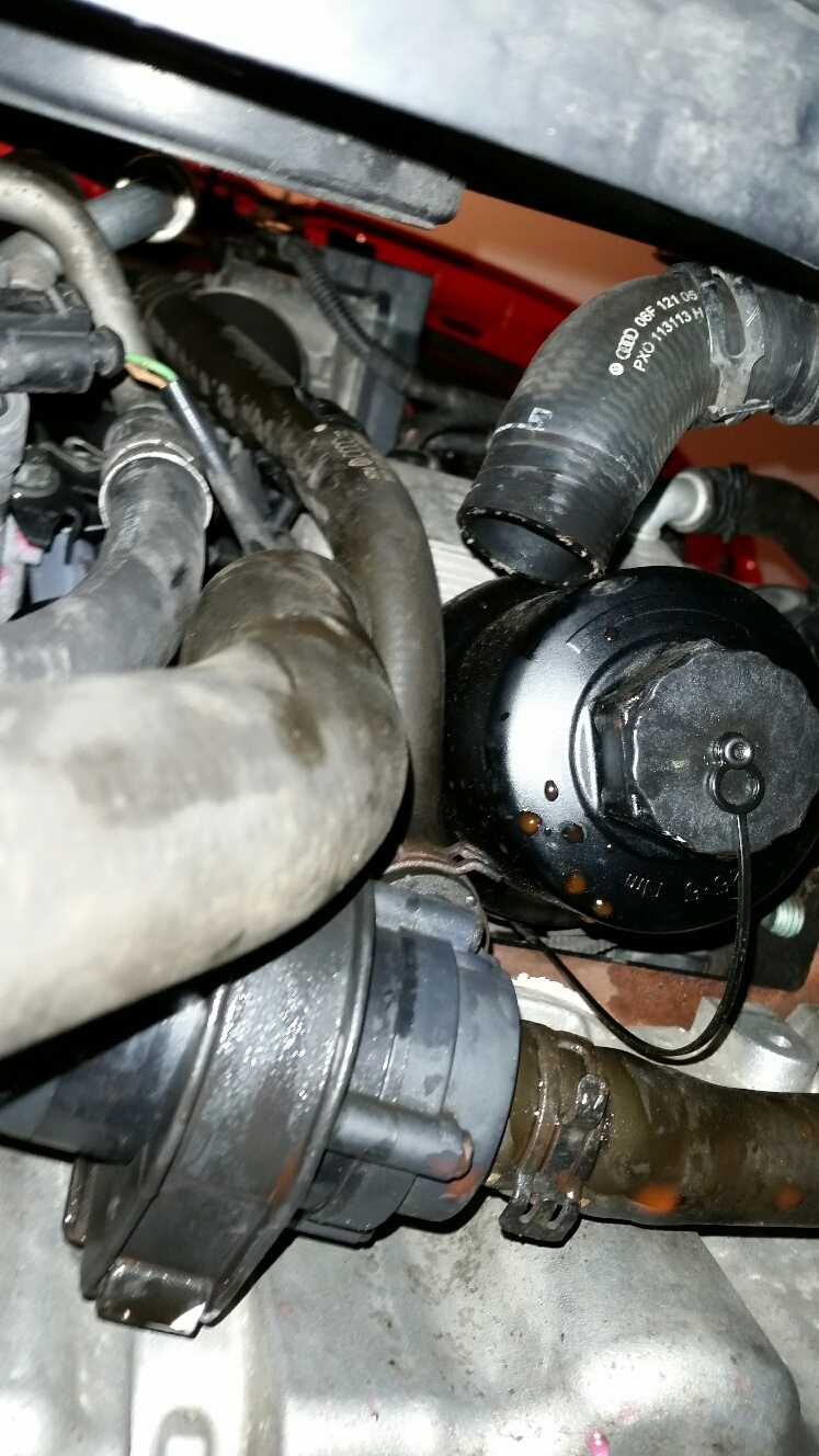

Ive just done my cambelt, water pump and both the thermostats. Mine is an 05. Ur inline stat is pretty easy to locate. Heres a pic to help u. If u imagine ur car didnt have the front end on its on the pipe to the left of the throttle body pipe.  I took a couple pics. Its on the pipe with the yellow writing.  The actual stat is next to the wiring loom
Dont even bother trying without hose clip pliers
I've changed the inline stat by the battery. But can't find another one.
Are you sure an AXX engine with dsg would have two??
see pic below.
05 | Tornado Red | DSG
