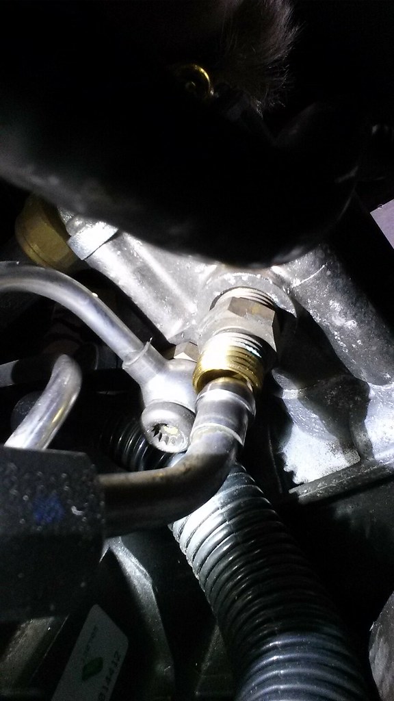

I went through the usual steps of removing the engine cover, and noticed my HPFP had 2 metal lines underneath.
I didn't have a mirror to hand, so stuck my phone in, looking upward (photo taken after I'd removed the first fuel line)
That'll be the M8 triple square. Luckily I had a set in my kit (needed to remove the front seat mounting bolts)

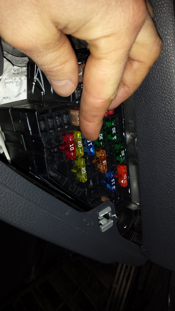

One of the online guides suggested removing the HPFP fuse and starting the engine, which would cause the pump to depressurise. I checked some wiring guides online, and found the #27 fuse (the blue 15a I'm pointing to...took a photo so I didn't return it to the wrong location!)
Removed the top sensor from the HPFP first, started the car for 10 seconds, then killed it. Remove the fuse, start the car for 10 seconds again (it starts to splutter) then kill it.

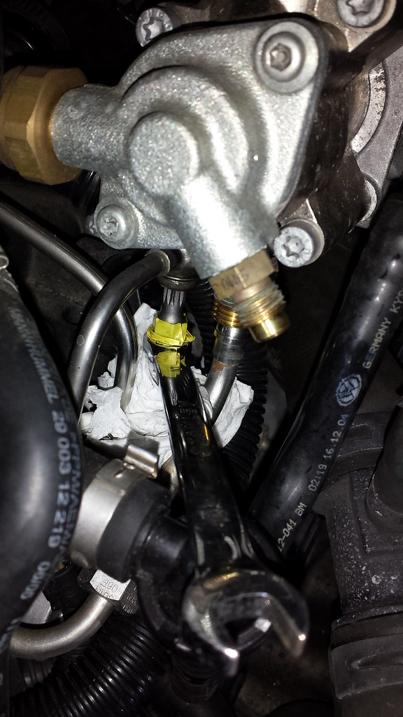

When I went to release the pressure from the schrader valve, only a weak spurt of petrol came out (I stupidly didn't have any rags, and kitchen towel isn't really the best thing for the job)
This is the only angle I could get to work on removing the banjo bolt. A ratchet spanner would have been really handy  :ashamed: But I had to crack on like this, taking it slowly as not to cross-thread anything, making a lot of small turns. The 'leccy tape helps with stopping the M8 from falling down onto the undertray.
Once that's loose, as well as the other fuel line, pressure release valve and the T30 torx fixings, you can remove the HPFP and get to the follower. A bit of fuel may spill out when you remove the pump, so have the rags to hand.
