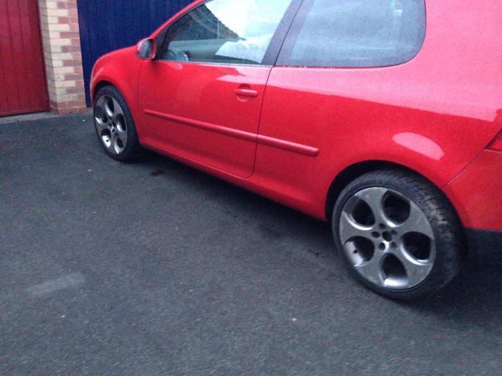

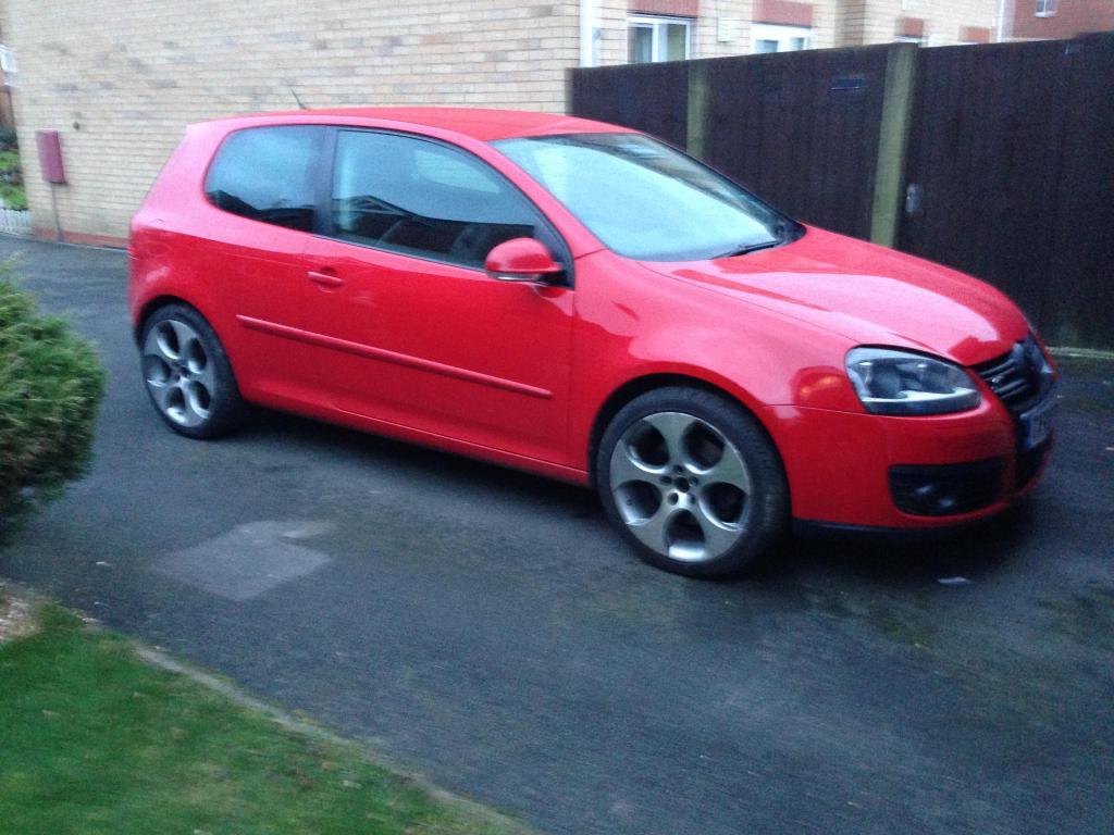

So new wheels are on and very happy with them indeed.
Just need to get round to doing a refurb and spray on them as I think Black will look better than Silver.
Sorry for the bad phone pics as it was starting to rain and I was cold so rush job  :confused:

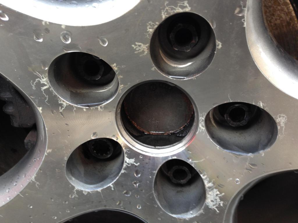

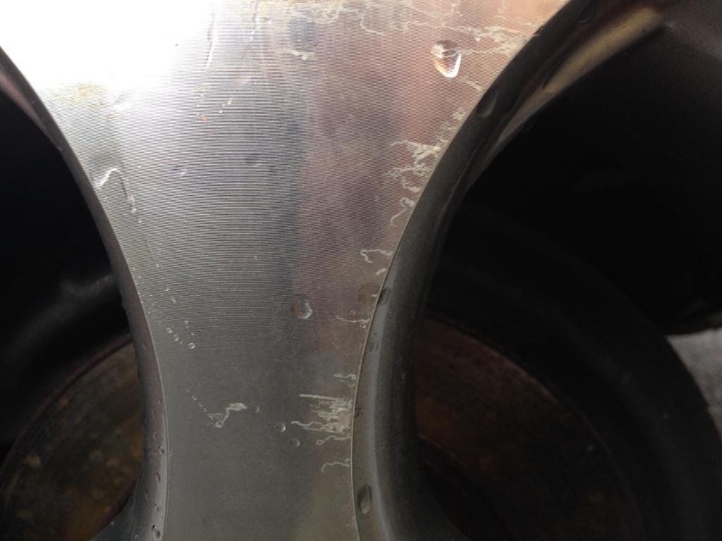

Sorry to post some more pictures but just checking the wheels out this morning as I am looking at doing my own refurb and spray afterwards.
Looking at the wheels the obvious is around most of the wheels is some kerbing so that will need sanding and filling. However over the face of one of the wheels there is marks as you can see in the pictures. They face is smooth so no scratching or anything when rubbing my finger over the areas. It almost looks like the laquer is coming off which is not an issue as would need this off if I am going to spray anyway.
Can anyone with more knowledge confirm from the pics what these marks are.
