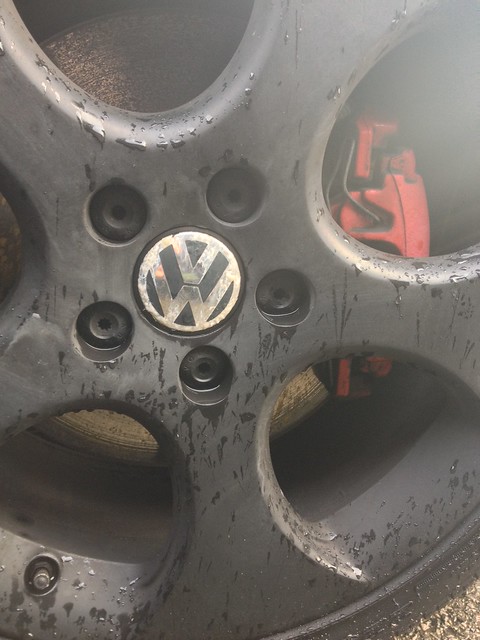

This is going to seen like a very stupid question. In fact no, it IS a stupid question but unfortunately i need to ask.
The wheel bolts on my car look like this:
To me they look like i need a torx bit to undo them. I'm used to using a 17mm socket on my old car so im just very confused.

 :signLOL:
There just caps covering the 17mm bolts! There is a proper tool to remove them, could be in with your spare tyre?
Check this link for more info
http://www.vwgenuineparts.co.uk/vw_wheel_nut_cap_removal.shtml

AHAH! I feel really really stupid now :scared:
Thanks for the reply! Appreciate the quick response.

Yeah cover caps pal
If u have not got the right tool in your boot to pop them out
You can gently use a set of pliers to remove them

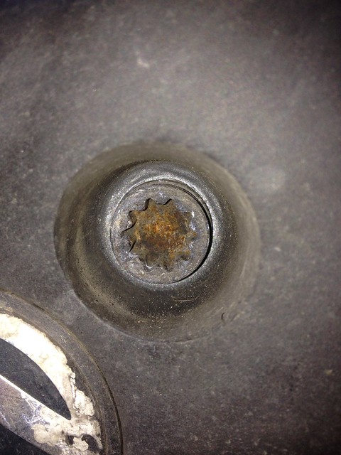

After having a new tyre fitted today, i realised i didn't have any locking wheel nuts on the rear wheels. Went to the fronts and took off the caps. Both front wheels have the locking wheel nuts, but i dont have a bloody key for them!! I'm going to order some aftermarket wheel nuts off ebay later on
http://www.ebay.co.uk/itm/ALLOY-WHEEL-LOCK-BOLTS-FOR-VW-VOLKSWAGEN-GOLF-GTI-Mk4-Mk5-Mk6-LOCKING-NUTS-6R-/321043468994?pt=UK_Cars_Parts_Vehicles_Wheels_tyres_Trim_Nuts_ET&fits=Plat_Gen%3AMK+V%7CModel%3AGolf&hash=item4abfae92c2
Probably will get them, or some others but the correct specs are M14 x 1.5 with a radius/ball seat. The threads are 28mm long, correct?
Other than that, does any one in sheffield have a key, or think they have a key i can use for these locking wheel nuts when my new bolts arrive?

http://www.ebay.co.uk/itm/Genuine-New-Volkswagen-Audi-Skoda-Seat-Locking-Wheel-bolt-Key-Code-000-10-Spline-/151230879408?pt=UK_Cars_Parts_Vehicles_Wheels_tyres_Trim_Nuts_ET&hash=item23361016b0 i think its what i need :happy2:

It just look like a spline drive. With a decent set of spline sets you will hopefully find one that fits. I have the tools here but unfortunately I'm a little far away from you but I'm sure someone in sheffield should be able to lend you.

I bought a spline bolt from eBay, it fits :) but thank you for the reply, appreciate the effort.
