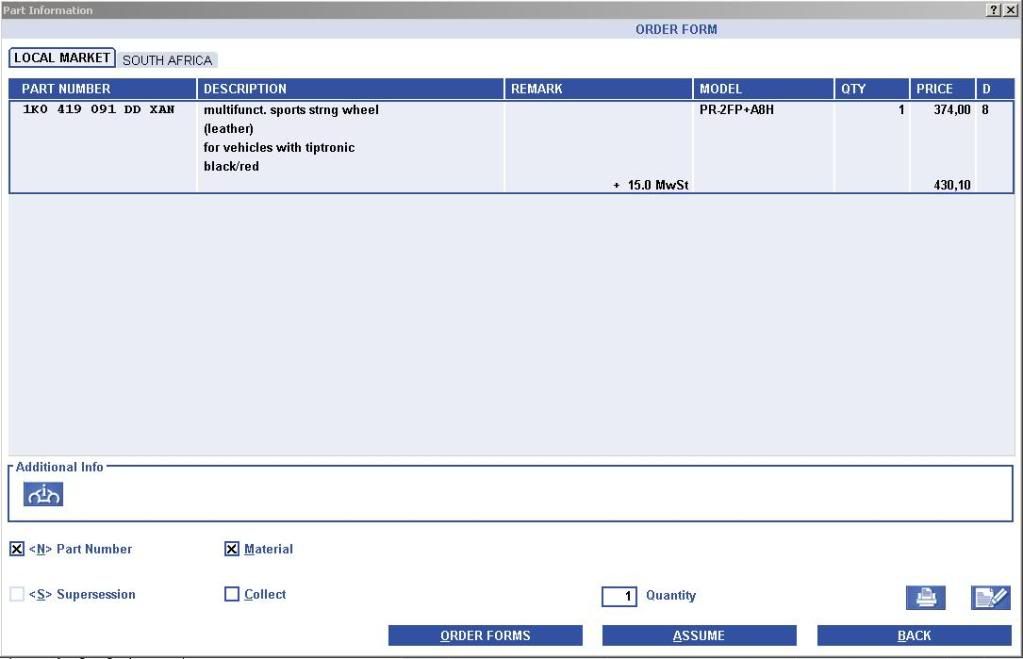

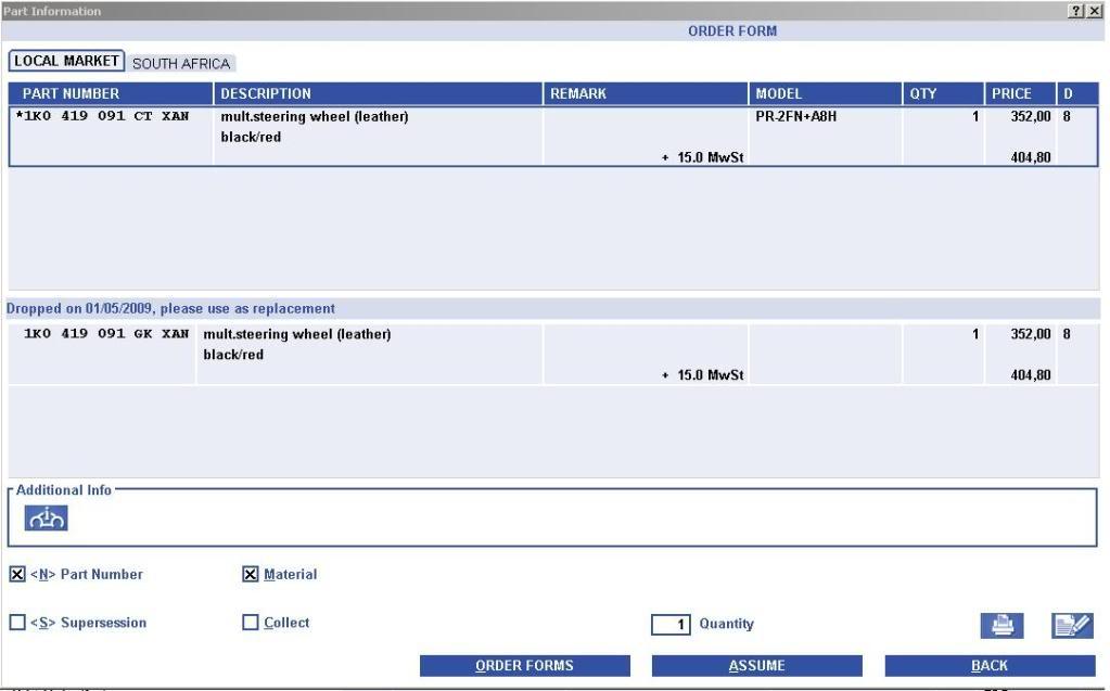

I think what is confusing your local parts guy is that the version for the manual cars isn't described as a "sports" wheels, but the code A8H indicates it is.
Here is the DSG version: -
And here is the Manual Version: -
