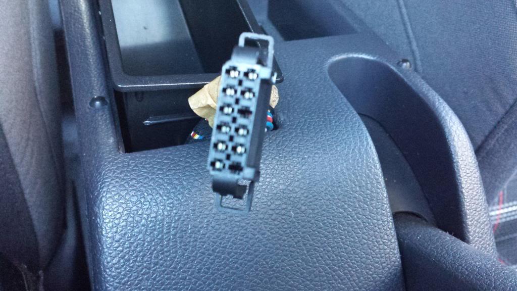

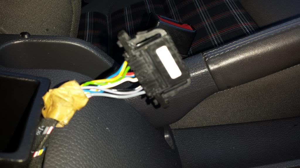

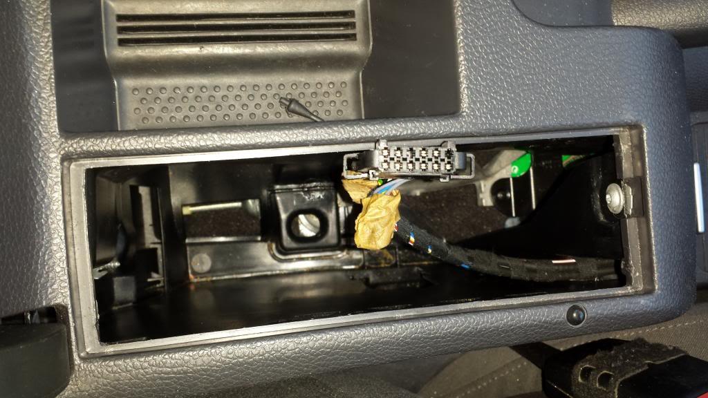

So I lift my arm rest and notice the tray was loose. So I pull it out and find this:
So My question is is this for a cd changer? and if so can this be adapted so that I can have a 3.5mm AUX in, for reference I have the rcd510
Thanks :happy2:

Looks like where the CD Multichanger would go..so would assume that.
Take radio out.
Buy OEM Ipod or Xcarlink kit.
Or ebay for 3.5mm but no charging, no head unit control (using ipod while driving is illegal)
Plug into CD multichanger socket.
Run cable into glovebox
Boom.

Thanking you Jay. I assume on the other end with be one of those blue connectors into the quadlock?
I prob just wait for an MDI instead

Most likely bud you can whip the hu out easy enough to see.
Yeah mdi would be better with track name etc
